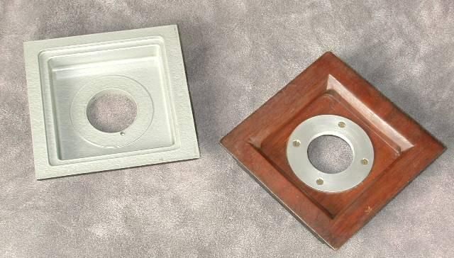

I measured my camera. I need a 4" x 4" board. The camera is 8 cm from board to ground glass fully collapsed. Looks like I need a recessed one. SK Grimes does not appear to have graphic recessed boards...at least online they don't. I'm assuming copal 0 is 34.7mm (35mm?).
Deleted member 19578
Recessed board?
I have a 4" x 4" board that is recessed 1.25" with a Copal 0 (35mm) opening:
$30 shipped (48-US)

Literally minutes before your post I purchased one from KEH. I think I might need a 32mm. Let me see if that fits and if it doesn't I'll get back to you on this one.

The lens board from KEH is going to work. Getting to the controls on the shutter is tough. I have to use a pen to adjust the aperture and am waiting for a 90 degree release cable. The important thing, mobility of the front standard, is still good. Looks like it's gonna be a good summer with this camera.
