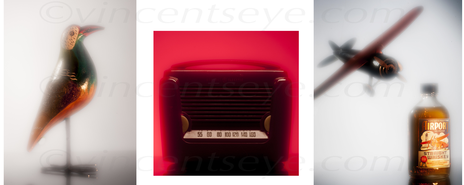

Here is a quick sample of what I can do in camera with this device. LR803.jpg7VW_0286.jpg
