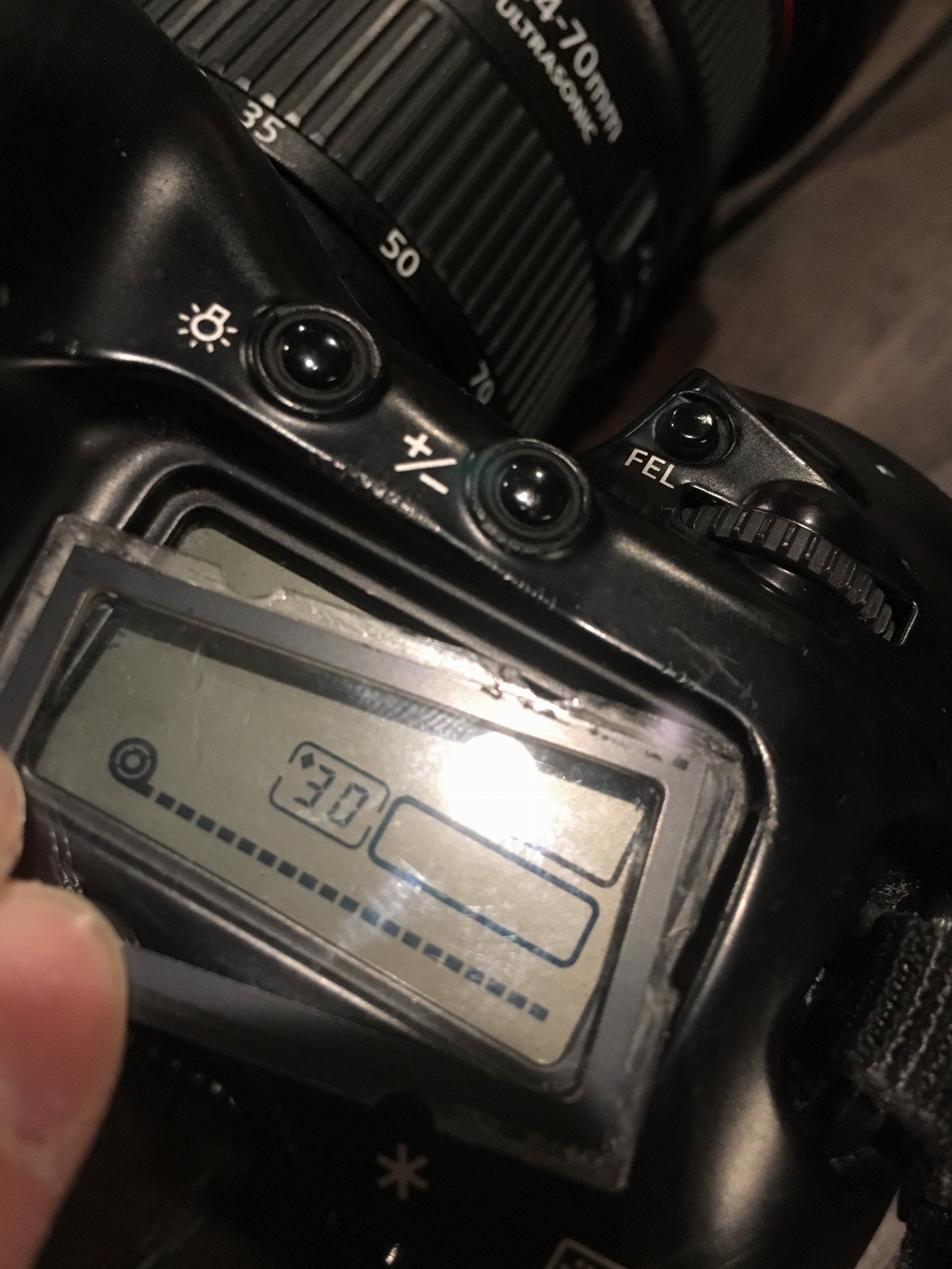

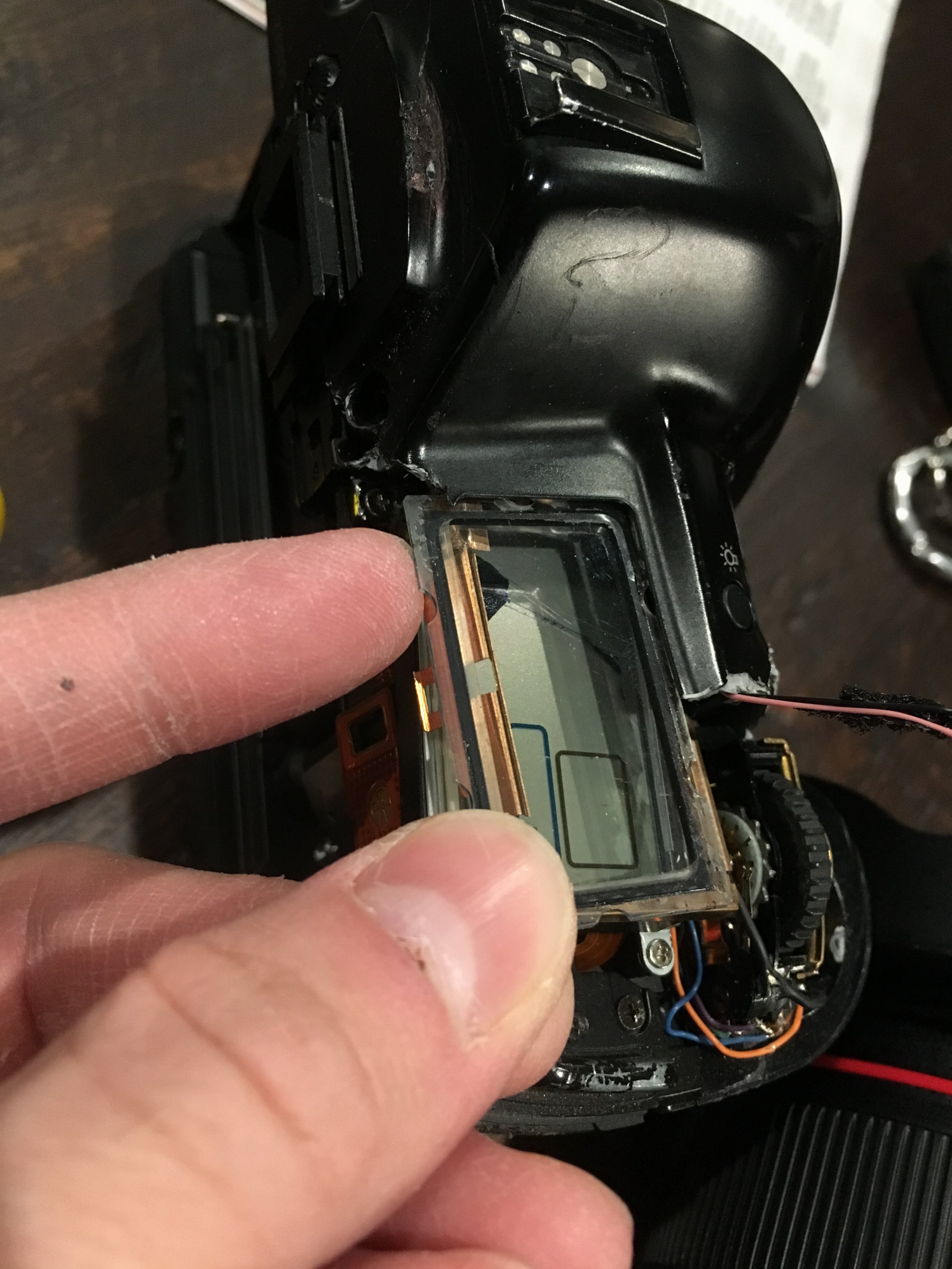

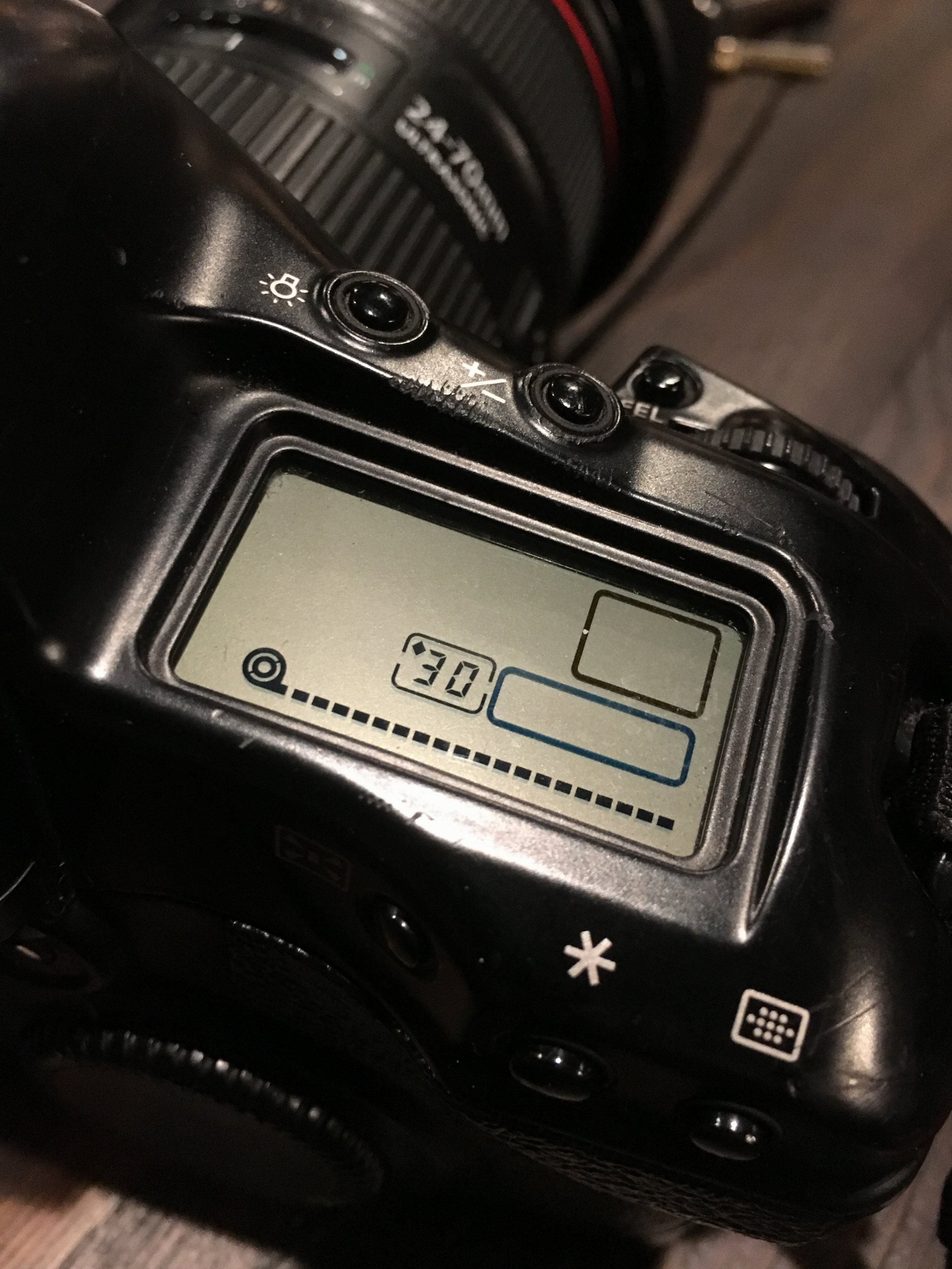

Dances with clouds was kind enough to send me his 1N
Unfortunately that window is not the same. The size is physically, the same but the 1V is an "inny" and the 1N is an "outy".
As in, the reason the 1V popped out is that the plastic seems to lock in by being glued down into the body.
The 1N window cannot physically pop out because it is inserted from inside the body and pressed up toward the outer part of the body.
I was on a little vacation and only had access to my pocket knife, but I'm skiing and wanted to insert this now so snow wouldn't get in, so I kinda "hacked" it out, so, embarrassingly showing these pics. If anyone else could use parts from a 1N I am happy to pass it forward. Other parts aren't damaged just the top plastic and LCD were damaged in my hack.
Suffice to say, still looking for a broken 1V
Thanks! (Pics below to visually explain why the 1N plastic cover doesn't work)
PS if anyone has a 1V they want to post a picture of theirs with the plastic screen that would also be helpful just to see what it looks like.
