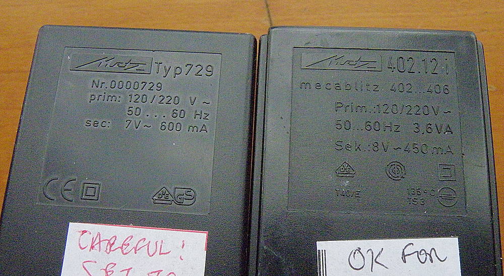

By the way -- my Battery Charger units I have -- i have 2 British ones with the 3 pins and can set 240 Volts and 2 GERMAN ones with the 45-CL1 flashes I was donated by a Camera Club member and they c an only be set to 120 Volts OR 220 VOLTS and have the German 2 pins . Also, ONE of them is marked 'Typ 729 7V 600Ma where the other is type 402.12 i 8 V 450mA --- which is correct to use ? The Donor said he had used the 220 V in UK on 240 V mains OK to charge batteries.

Those look like they were for the old 402 flashes - much older than your 45 series flashes.
I had one of the 402 units with a NiCad battery, but it wasn't nearly as much fun as the version with lead acid batteries that had to be regularly topped up with distilled water!

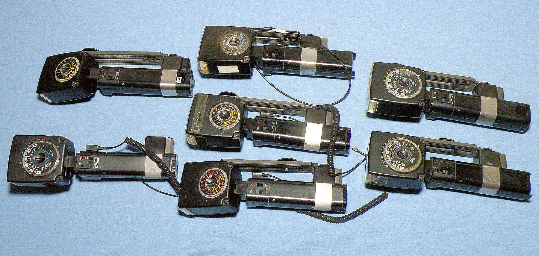

i need BOTH then as I have a 45CL-4 recently given by a Widow Lady and I have 7 Metz units now -- 2 bought, 5 given !

Guys, you mixing up terms and devices. (I know, the situation is confusing.)
But with these Metz flashes there are
-) mains units to feed the flashes for immediate operation
-) mains units to charge the batteries

I want the Mains Units for immediate Operation ---- N21 and N22 I showed the ones to charge the batteries.
