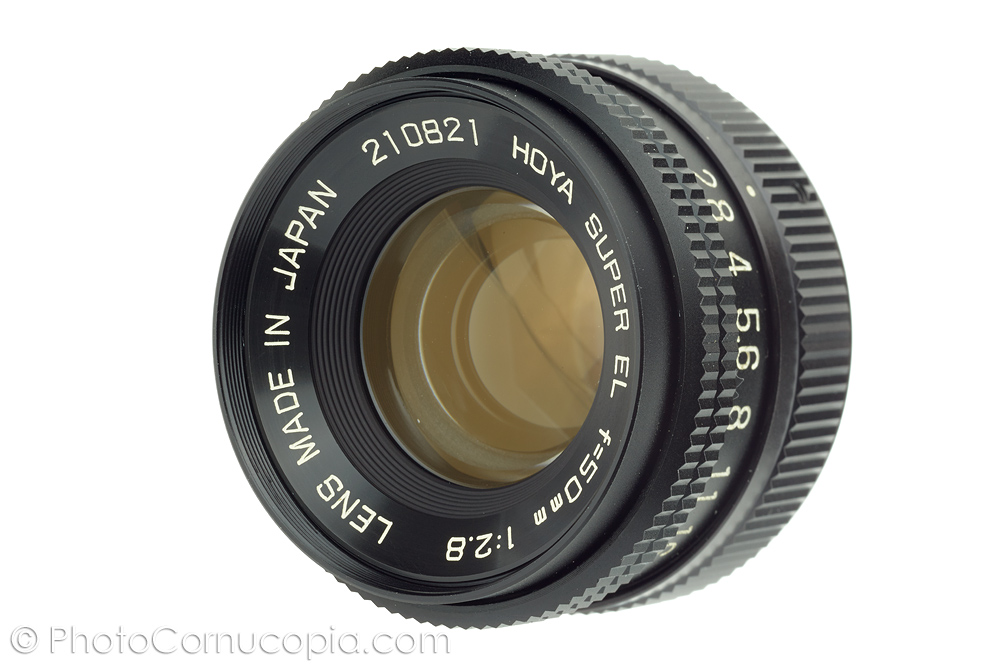

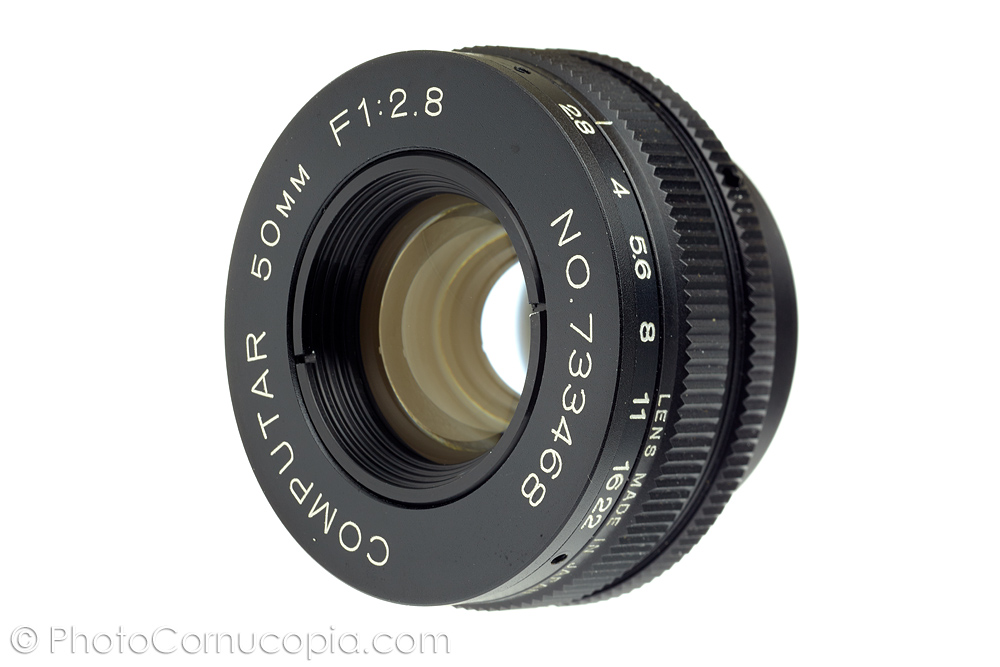

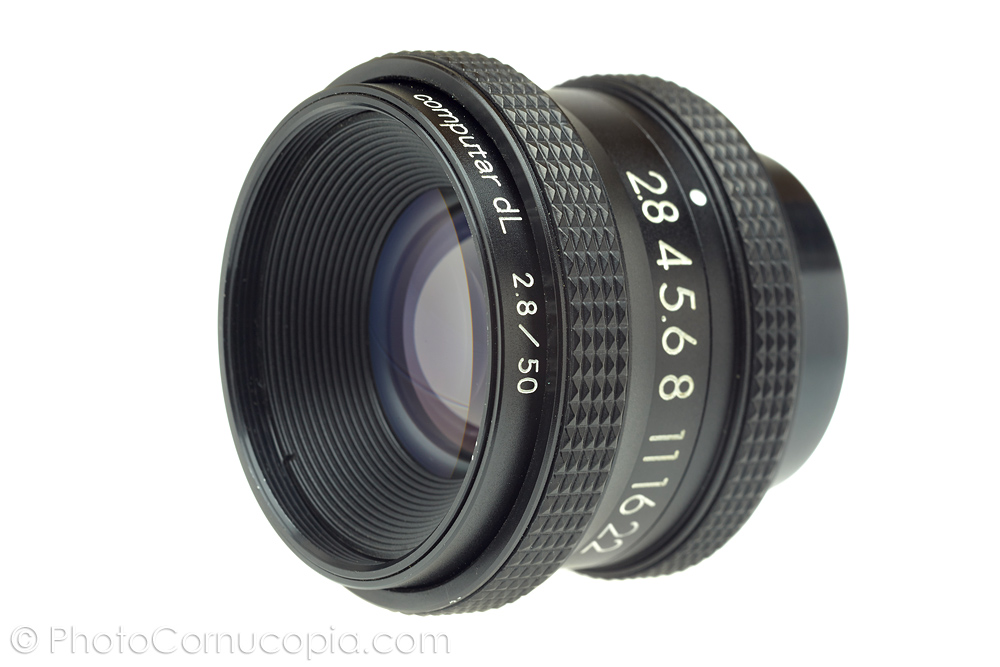

Just putting it out there, I do NOT think the Hoya/Yashica/Osawa-Tominon (same lens under three different brands) is the same as the Computar/Kowa dL 2.8/50. Am I missing something?
Hoya Syper EL 2.8/50
Computar dL 2.8/50, also, Kowa 2.8/50
Not to be confused with an early 'Computar' 2.8/50 which preceded the 'dL' line of lenses (shown below). This is a rebadged Japanese lens (I've seen the same lens under another brand name).
