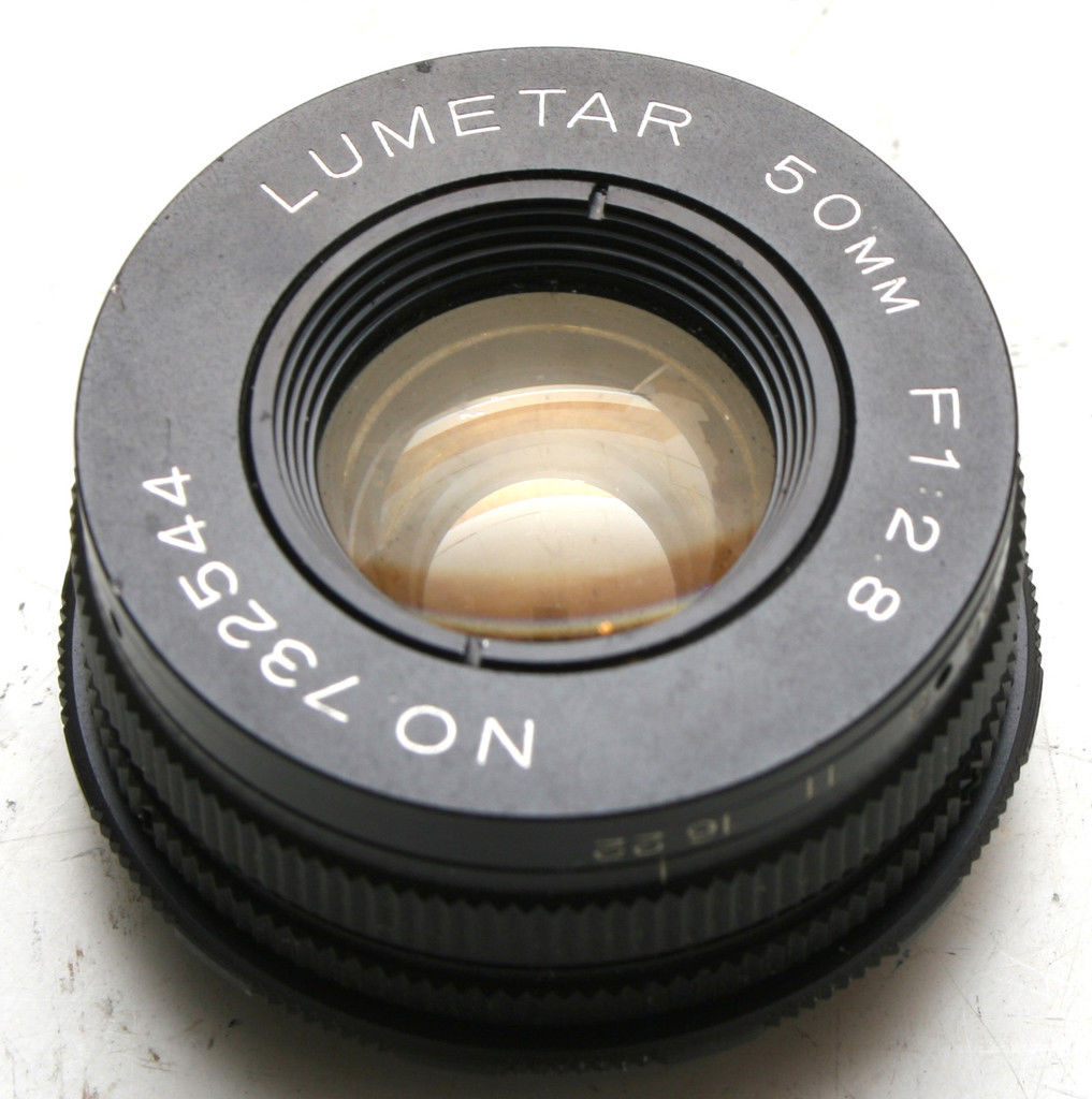

Just putting it out there, I do NOT think the Hoya/Yashica/Osawa-Tominon (same lens under three different brands) is the same as the Computar/Kowa dL 2.8/50. Am I missing something?
Hoya Syper EL 2.8/50
Computar dL 2.8/50, also, Kowa 2.8/50
Not to be confused with an early 'Computar' 2.8/50 which preceded the 'dL' line of lenses (shown below). This is a rebadged Japanese lens (I've seen the same lens under another brand name).
The bottom Computar looks exactly like my Honeywell Lumentar.
Thanks! I couldn't remember which brand I'd seen the Computar under, but it was, as you say, the Honeywell LUMETAR (not Lumentar). I'm fairly sure that at that time Computar was just importing gear and not designing their own lenses so this Japanese lens has nothing to do with Computar except the name plate.
Have you used it, is it any good? I haven't even tried it.
Haven't used it yet--it's at the bottom of my list of lenses to try--I have SO many.
