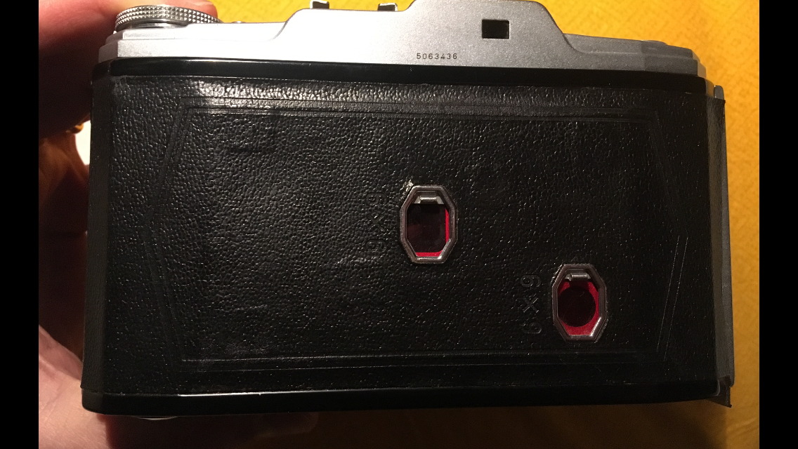

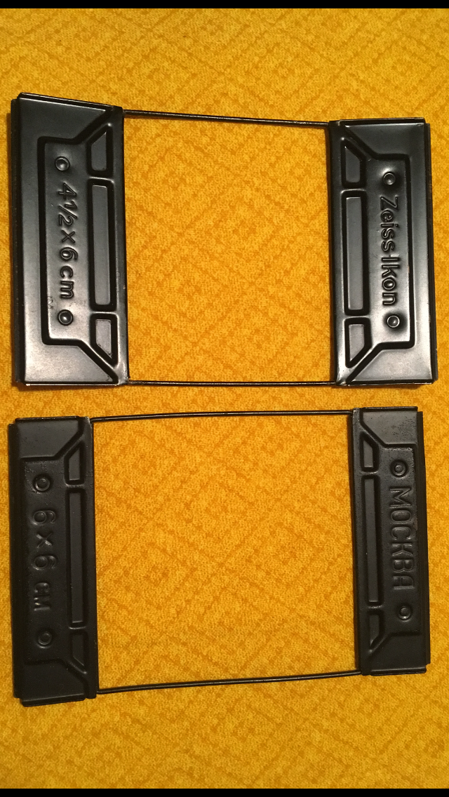

I have the zeiss 4,5x6 mask and the mockba 6x6 mask. They fit every zeiss 6x9 model depending on red window position: some have two (4,5 and 6 x 6) some have two (4,5 and 6 x 9) some only one for 6x9.

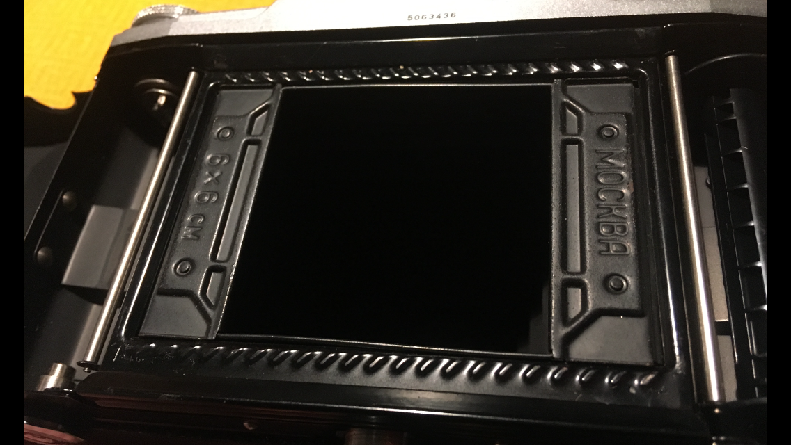

Here is one of my erconas II with the mockba 6x6 mask
Even if really similar the Mockba mask does not fit as well as the zeiss one. I’d look for the zeiss but if you need my 4,5 x 6 or the 6x6 Mockba I could send it to you.
