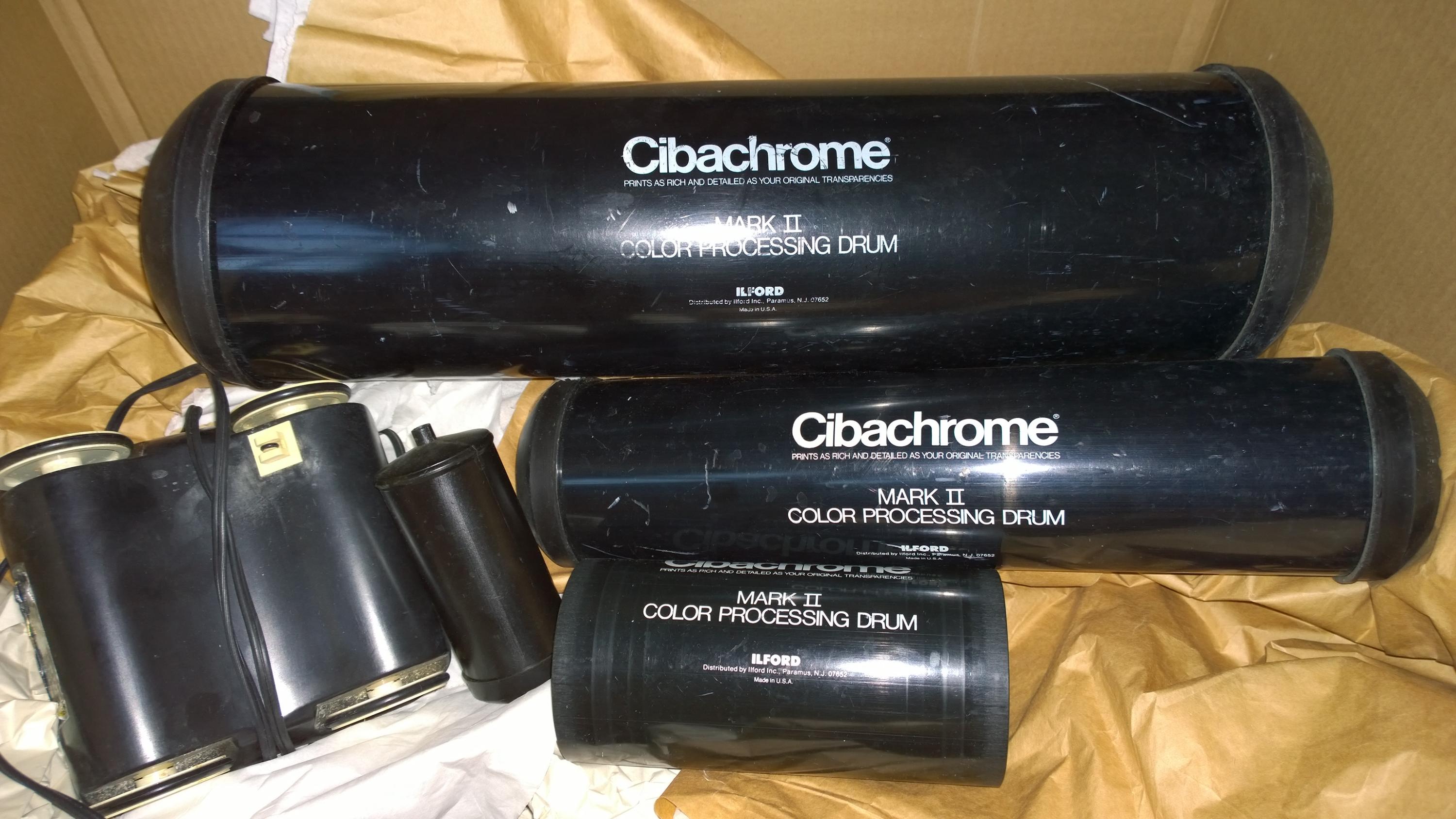

Remembered this box last night. The big drum is 20" from the inside of the end caps and about 19.5" outside diameter. Is this what you're looking for or is there another smaller 16x20?
I have something smaller from cibachrome. It has odd caps that have recessed cones, are they useable for b&w paper development?

Shouldn't be any problem. The only drawback of the Cibachrome drums is that they're completely smooth inside, so prints smaller than the nominal size the drum is designed for can't be easily separated. The end cap design was specifically designed for the small amount of expensive Ciba chemicals used for their color process. Personally, I like to use a more generous amount of solution both for film and print processing in a drum, so I prefer the Chromega drums, but I'm probably just being a bit conservative.
