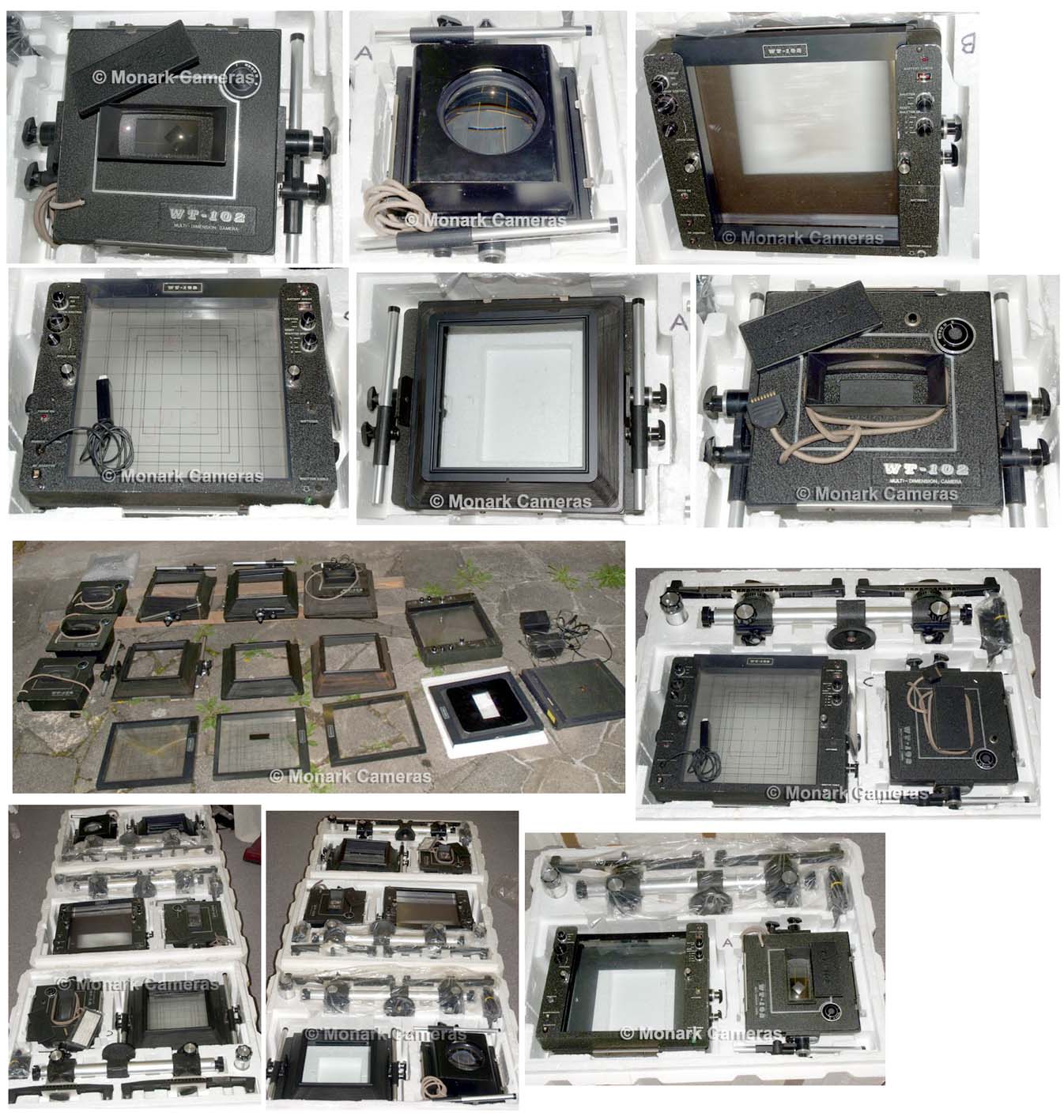

You'll all be glad to hear that I managed to get my hands on these cameras before they were lost forever. Tim, from monarch was having to downsize his warehouse and was planning to throw them away (!!!) they but now they are safe and sound in my house.

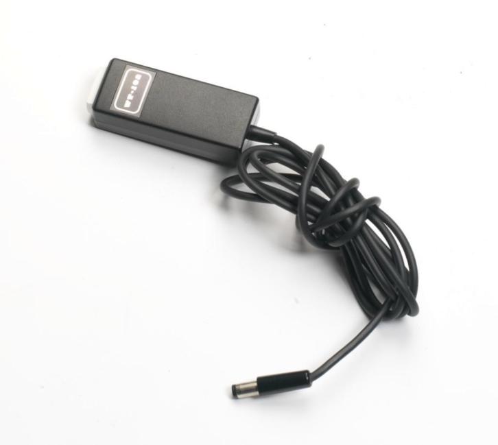

He had sold one complete set from the images you posted, so he sent me the other two (almost complete) working WT-102 cameras with two power adapters, and one shutter release. I already had one with no power adapter and no shutter release but with one rail.
So I now have three lenticular WT-102s and they all seem to be working, however I have ZERO film backs so I am yet to try them out properly.

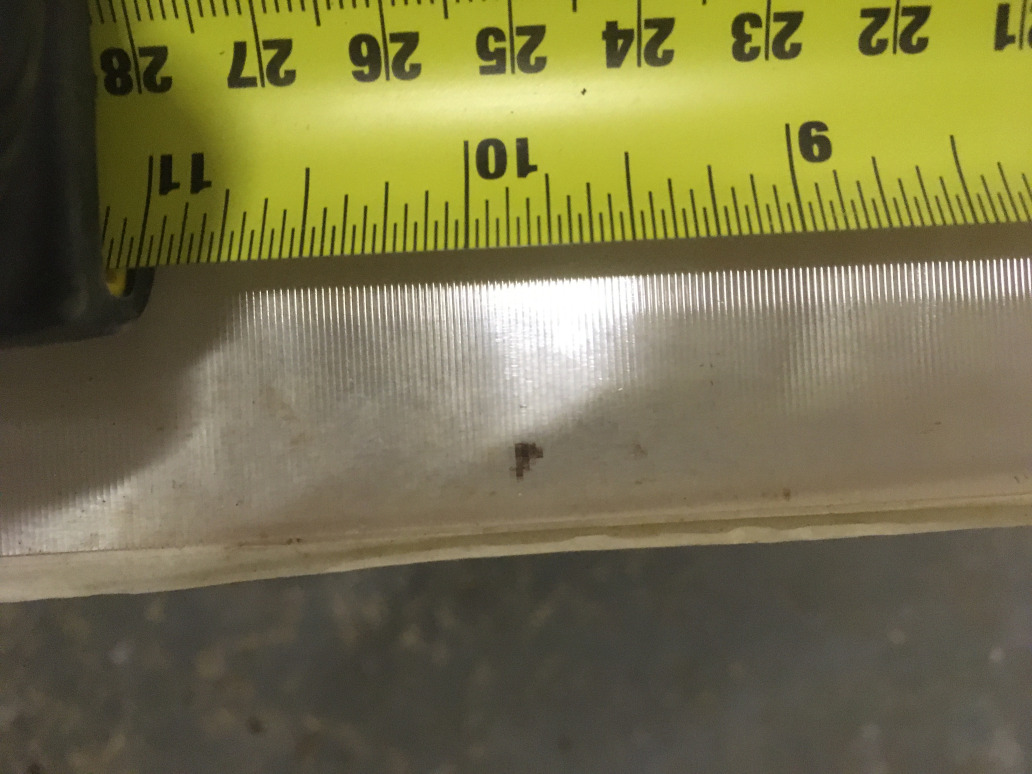

Hi Richard
I got a pack of ten screens 16x20 with the camera, so have no idea how much they cost, I will include an image so you can count the lines per inch, I managed to count 25.
Will also upload image of pack with name on, but not sure if the company are still trading, hope this helps.
RickiView attachment 264708 View attachment 264709
Just like Richard I would love to know how many lines per inch they are. I'm guessing that out of the vast offer of lenticular sheets from aliexpress, at least one of them should work. Has anyone here tried?
I think there are some printed sheets that you can use to test lenticular sheets and find out how many lpi they are etc.

Do you still have the camera? I myself have three WT 102 cameras; one without a lenticular back intended for normal use.
At that time there were four special lenses available ranging from wide angle, standard, telephoto and even macro.

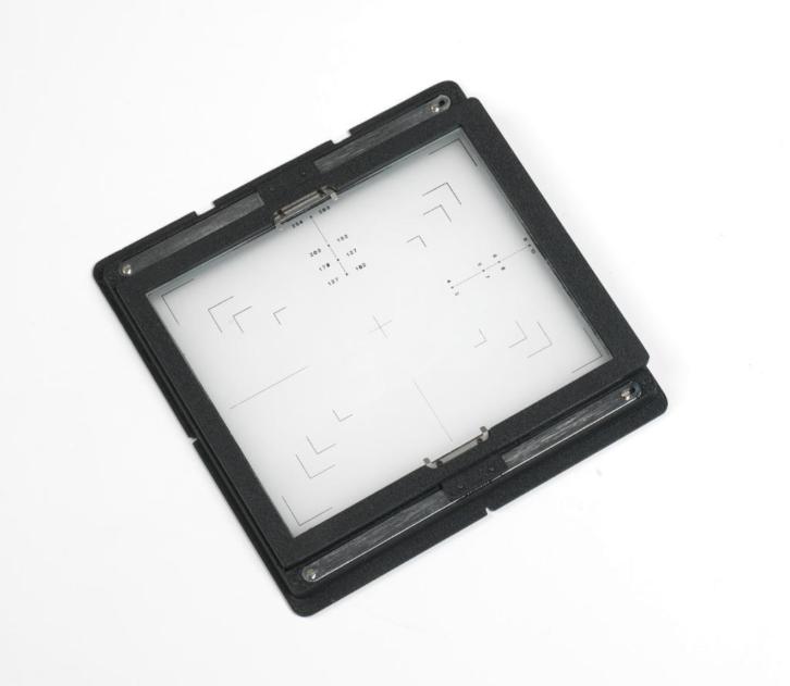

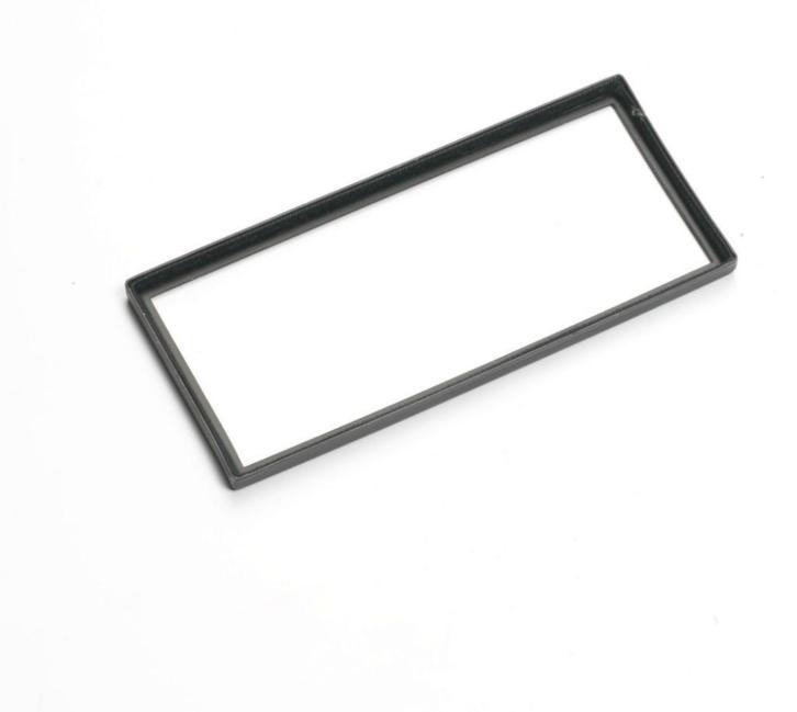

From the top of my head a standard set contained the following parts:
- Camera lens board
- 300 mm special lens
- Rectangular lens filter holder
- Bellows
- Camera rail + tripod mount + extension rail
- Camera back - lenticular
- Shutter release cable (not the ones shown in the photos) into camera back
- focusing screen
- Power adapter
- Camera back - standard 8x10 (non-lenticular) for normal film use
- No-hole blank lens board (for normal lenses)
- Film holders (2)
- User and warranty information
(See pictures of missing items, except blank lens board)View attachment 254414 View attachment 254415 View attachment 254416 View attachment 254417 View attachment 254418 View attachment 254419 View attachment 254420 View attachment 254421 )
