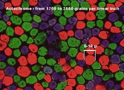

Autochrome.
Grains are from 5-10 microns, 1700-2500 grains per linear inch

From your examples, the Autochrome should be much less grainy and "pixellated?" than Dufay, but not from what I saw. I have trouble scanning Autochromes, but those who have scanned Dufay seem to have a lot less problems. It might be due to the graininess of the emulsion then. IDK.
You can see the crushing of the Autochrome grains in the first example.
