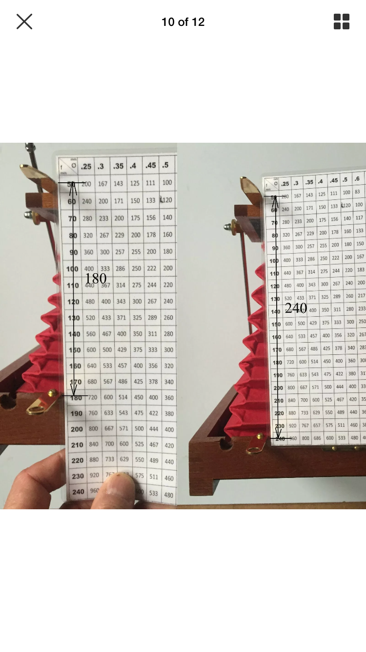

I'd like to ask you guys about your opinion of this camera. I saw this piece of kit months ago but I was hesitating because I'm not sure if it's that easy to play with the focal length and the pinhole diameter to get a decent or sharp photo Or is it? So can I really use any diameter for any focal length and vice versa?
Also it can be a challenge/lot of experimenting to determine the angle of view as there are so many possibilities.

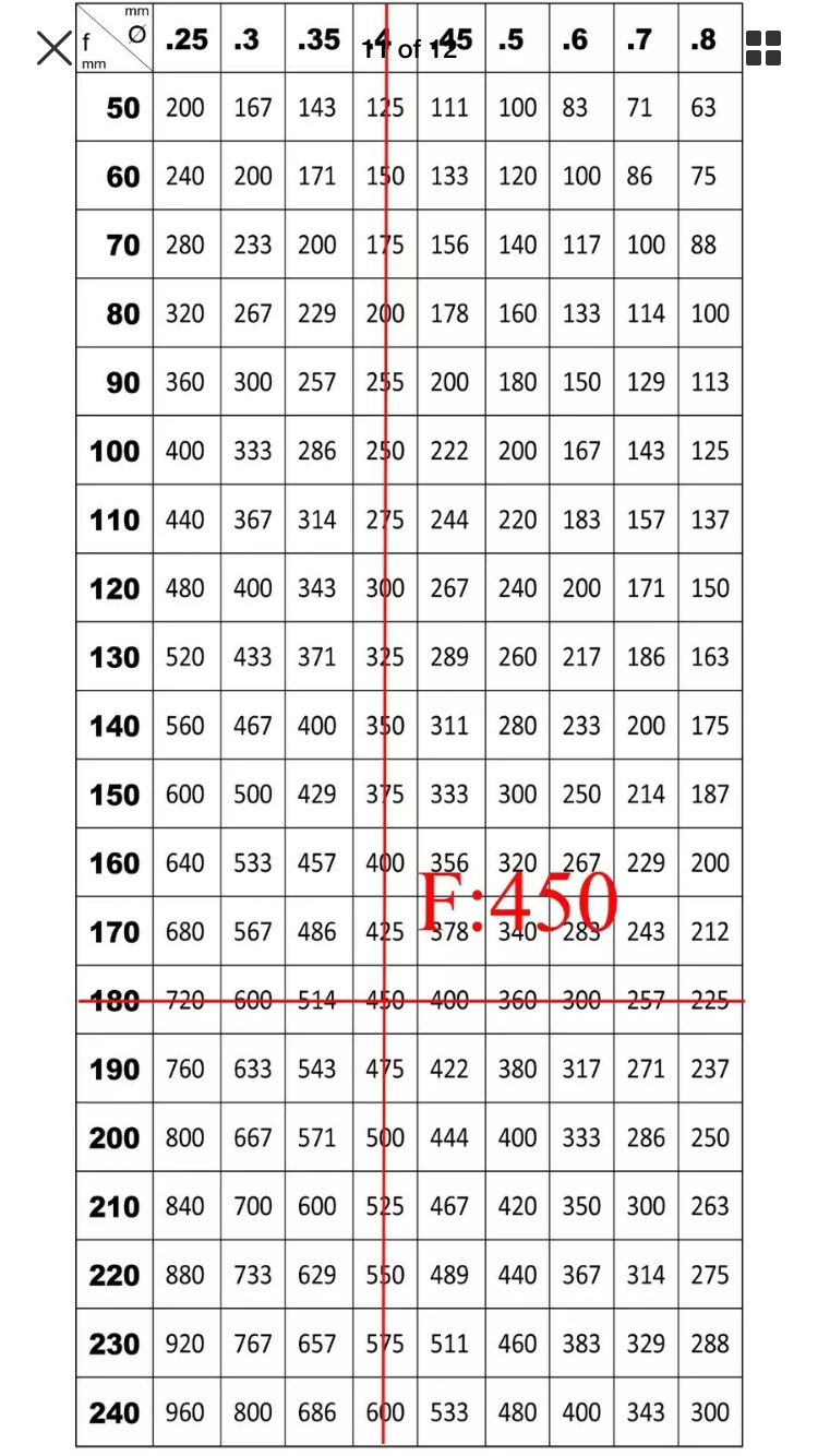

8FCE448E-B1BB-46E6-A041-944940E67146.png A9BBBB96-C461-4ABA-BE95-58F41B56036B.png
Yes, you need to find the correct pinhole diameter that corresponds to the FL you will be using. I would assume that the FL would be marked on the bellows extension, and that a pinhole diameter would be specified for that FL.
No it’s not. It’s totally up to the user which diameter is used for the focal lengths and vice versa.
So it seems to me that it’s rather an experimental camera or gives a lot of possibilities to experiment. Might be even too many for me.
Well now, you just have to take a few deep breaths and make a handy chart or three, approaching it one step at a time. :smile:
You could print a scale on index stock with the minimum and maximum focal lengths and include two or three intermediate distances, all laid out such that you use it like a ruler to measure from roughly the front of the film holder to the plane of the pinhole. The measurement doesn't need super precision. For all of those distance marks, and inputting the size of your film, run the numbers through Pinhole Designer or Mr. Pinhole and see what the "optimum" pinhole size is for each distance. That would probably be quite sufficient, but you could interpolate by guess to refine that if an in-between situation arose "in the field."
I have Micro$oft Publisher for other reasons, which is my goto when I need fairly accurate layouts, but I'm suspecting you could use a spreadsheet and adjust the column widths to simultaneously create a scale and tables. I can envision a sort of pocket sized card with a scale along the long edge and a table with the pinhole size and vertically below that a series of exposure times adjusted for the tiny apertures relative to what you can meter. When I do that sort of thing, I usually just use the clear packaging tape that's available around here to effectively laminate the card (both sides) to protect it a bit from weather and handling.
There are no third order differential equations needed! :errm:
