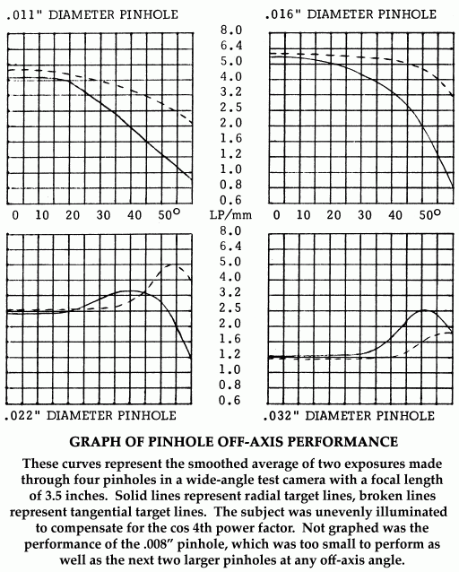

Here is the formula by Lord Raleigh (1842-1919), thus un-biased by a pinhole community...
hole diameter = 2 x 0.95 x SquareRoot (extension x wavelength)
Lord Raleigh was perhaps more of a scientist than photographer. His formula gives a pinhole about 1.25 percent larger than the optimum size that I prefer after years of pinhole photography. His formula may be better for wide angle pinhole cameras because it sacrifices some central sharpness for sharper corners. I prefer Pinhole Designer for most calculations. In the graph for the .011 pinhole, the user constant was 1.3. For the .016 graph, the user constant was 1.4. For the .022 graph, the user constant was perhaps 2.2. To derive these charts I photographed a target similar to the 1951 USAF text chart. Evaluation of the results depended upon my interpretation of the results in line/pair per mm.. Others may interpret differently. These charts do give a photographer some information to narrow down the range of optimum pinhole size, especially for wide-angle cameras. I usually choose a user constant of 1.4 in Pinhole Designer.When doing pinhole photography, esthetics is more important than technical precision. Note that optimum pinhole macro-photography requires slightly smaller pinholes than do more distant subjects, but the formula for that will have to wait for another day.
