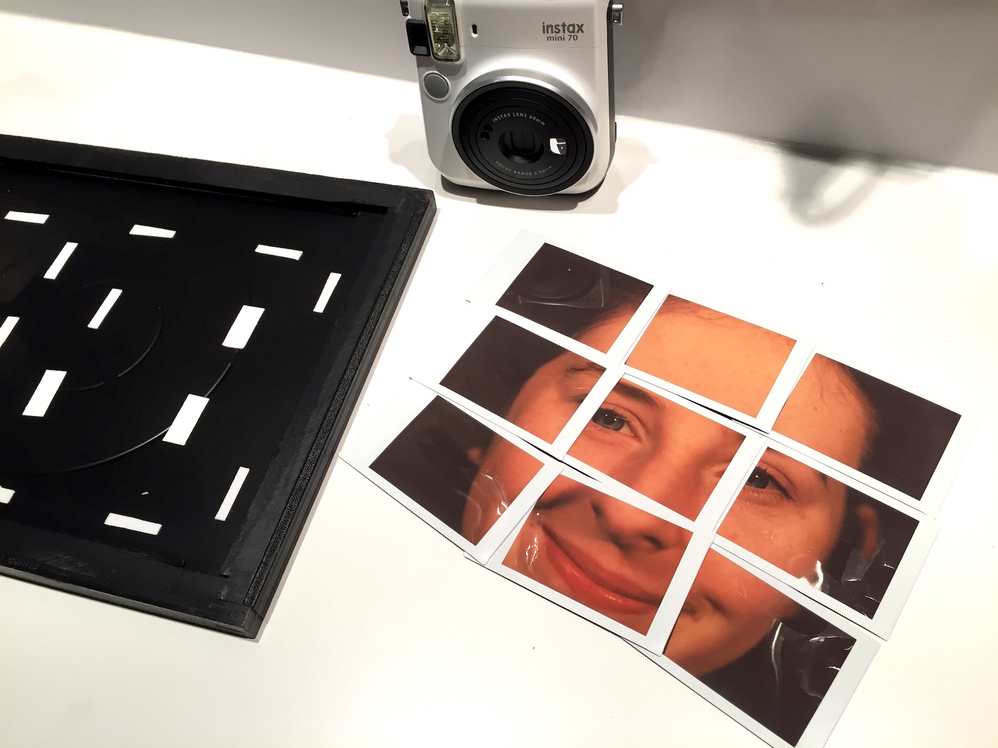

Maybe less interest now that Instax is around. Instax film exposes through the back (no mirror needed) and is not a multiple-component system (no cartridge needed). So it can be exposed in any camera and uses simple squeeze-rollers for processing. This is my version of 'home made' 8x10 polaroid. Each piece of the 8x10 was processed in the instax camera after exposure in the 8x10 camera.

How did you do that? Remove film and load on film holder, then reload into original film holder thing and run through the instax camera?

The white on the 8x10 film holder represents two-sided tape that was used to position the nine pieces of Instax film in the film holder. After exposure in the 8x10 camera, the nine pices were loaded back into a Instax cartridge (with the little light trap removed) and processed in the camera. If you open and close the back after each 'exposure' the flash won't go off. Just do that nine times in the dark and it spits out the nine images. Then you can turn on the lights and watch them develop.

Thanks, I may have to try that myself.
