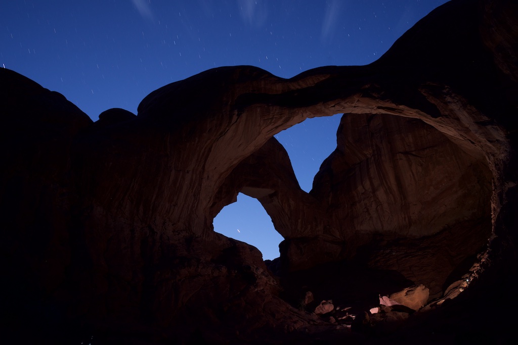

one issue you'll have is reciprocity failure. I've never done this on film for that reason. I can give you an example in digital. This is really unedited:
Exposure is ISO 800, ƒ8, 2min 7 sec. If you go wide open on an ƒ4 lens you gain 2 stops, so 2min drops to maybe 30 seconds, which will have less reciprocity failure. The glow in the distand are the lights from Moab, and the light under the arch was somone else doing light painting while I was shooting. (sorry for posting digital, but if this camera--Pentax K1ii--is accurate on ISO setting it would give a starting point to get similar results.)
I would add that a) you need to do some tests, and b) after researhing films, mu understanding is that while 100 ISO seems bad, Provia has the same resistance to reciprocity failure that Acros has. So it MAY not require much more time than another film with significant failure.
