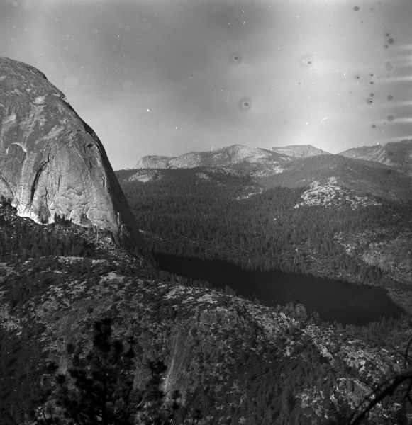

I've been shooting film for decades and have always done a great job developing film. I had just changed the light traps on my Hasselblad backs for the first time ever and had to test them out. I went to Yosemite and decided to take a panorama with the Gigapan using film. So I shot 12 photos, went to reload the film back...uh...only ONE roll of 100 ISO film and I just used it. I had 400 ISO but decided I didn't want to see the grain. So one roll was all I shot.
I brought it home, developed it and was mortified at what I developed. The light trap, for one, didn't work. There were light leaks everywhere. I need to redo it correctly (thank goodness I only shot one roll). I didn't tap the developing tank hard enough to release the air bubbles because there were tons of it. The development looked very uneven, though that could have been caused by the light leak. Worse of all it looked like I didn't use Photo-flo properly, if that's possible, as there were water marks everywhere. It was just a mess. All I could do was laugh at the results.
I'm going to post my most embarrassing moment because I want people who are just learning to know that even with decades of experience developing film that it's still possible to screw up a roll of film. Also goes to show that things happen for a reason. If I had more than one roll of ISO 100 film I would have ruined them all.

I usually do the same but this time my prayers weren't answered. Hahah. It was so disappointing when saw the little "streaks" in the corner from the poor light trap install I did, but when I proofed the negatives I was like "what the heck?"

My wife said almost the same thing. She said it looked like a bunch of horizontal meteors coming down on the Earth.

With regards to replacing the light traps in a Hasselblad back, I have one that needs to be done.
I already have the materials. Where do you think you went wrong? I'd like to learn something from your 'experience'.

I haven't had a chance to try it out for "real" but I checked the trap and it is indeed light tight now. I purchased the light traps from ebay and after trying it with the results you saw I felt dejected. I wrote Hasselblad and they indeed can provide the light traps for $18 plus shipping. That's basically the same cost as the ebay one AND it'll be the real thing.
So, before I plopped down $36+shipping I decided to try again. I watched the video on how to change the light trap on Youtube. There's a black cloth strip on the plate you take off when changing the light traps. The cloth was worn out, but what I did was peel it off and turn it around. That was one thing. I pushed it into place with permanent double-sided tape, but I suspect it won't last long.
The second thing was before I took everything apart I took a bright flashlight and shined it through the slot where the dark slide went in. On the other end I was able to see a tiny amount of light shining through. Someone somewhere on a different forum had mentioned using felt instead of the foam for the light trap. I was going to do that until my wife mentioned that she had pants patches. So I cut it into a little strip and used the double-sided tape and put it on the light trap and put it altogether. I used the flashlight and there was zero light coming through. The dark slide is really tight going in, especially when the back is attached to the camera, but no light is going in.
When I need to change the light traps again, I'm just going to order it from Hasselblad and hope they have them in stock. Don't waste your time with the Ebay product.
