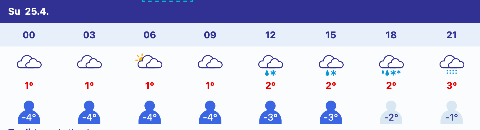

Tampere weather looks crappy for sunday :sad:

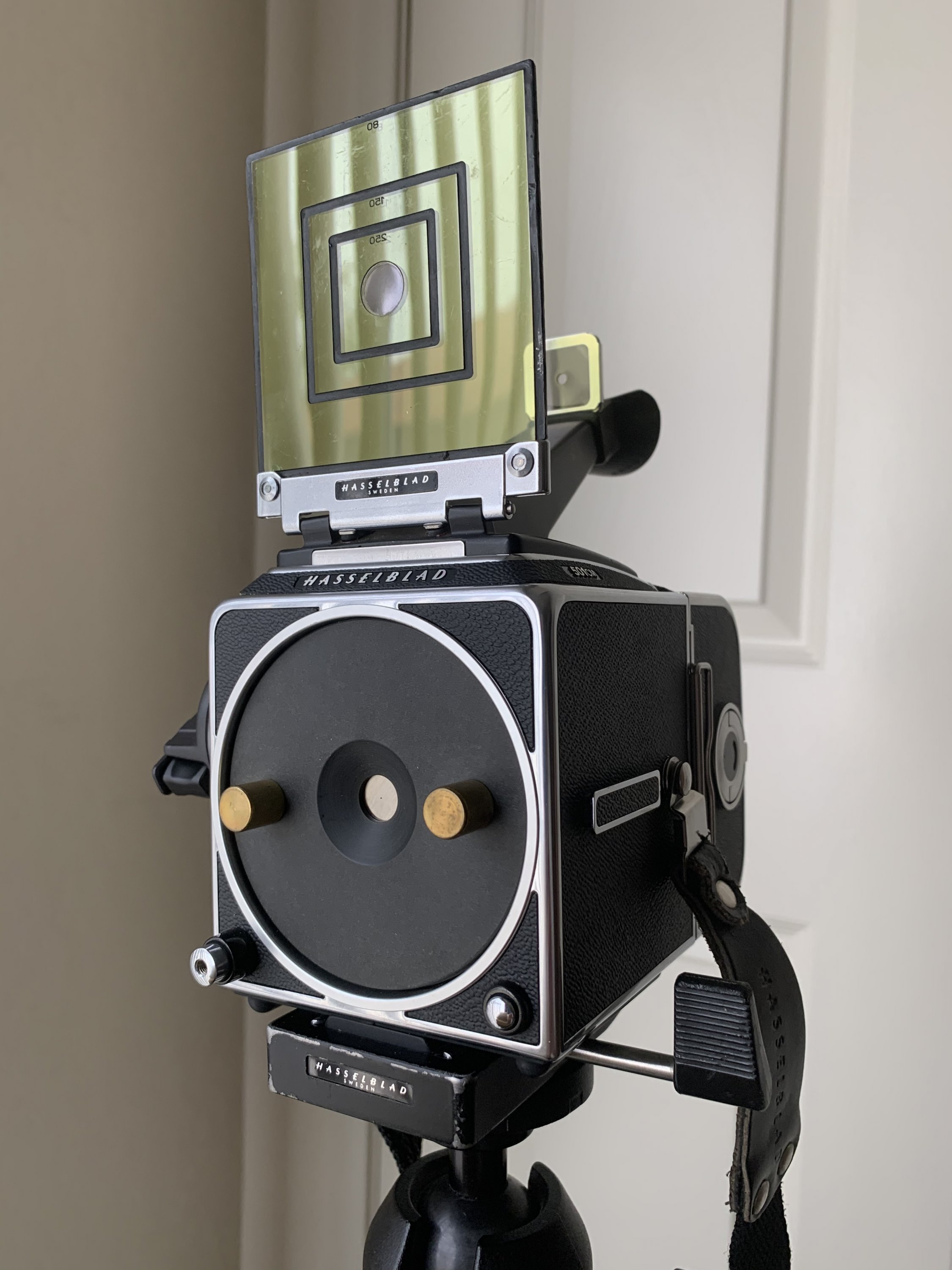

I might pull out my Hassyhole (503C/M with pinhole cap)... if time permits.

I am interested. Please tell me more about how you built it. Is it a pin hole in the body cap? I thought that the plastic was too thick for that.

I'm not sure what Brian is using, but the thickness of the plastic is, at least in my practice, irrelevant.
I take a body cap and drill a 1/4" or 3/8" hole through the center and tape a piece of thin metal with the actual pinhole in it to the inside of the body cap.
For the thin metal, brass shim stock is best but aluminum foil works in a pinch. Black gaffers tape (which has a matte finish') works best. Shiny electrical tape can lead to artifacts. (Internal reflections, I imagine.)
I then use a black marker to cover the remainder of the metal that the tape does not cover,

a pinhole camera that only a retired dentist could love.
Hassyhole or Holeyblad?

That is fancy!!
The conical hole does probably help with a cap that thick, but a regular old hole works just fine with a regular old camera.
And... the viewfinder takes away half the fun of pinhole photography... the not knowing exactly what will be in the frame!
If you find the thickness of the cap causing vignetting, you can also use a countersink to widen the hole on one side (leave it flat on the side with the pinhole). The Hasselblad body cap above has a fine example of that.
Of course, SLRs have a limitation on how wide angle the pinhole can be. For my RB67, for instance, the flange to film distance is close to 90 mm; to do any better, you'd have to use a conical recessed body cap and leave the mirror up all the time -- by which time you might as well build a box that mounts to the film magazine, or just build a whole camera out of scraps of this and that.

I just purchased mine, but I am not a dentist. Never was, so I cannot be a retired one. I wonder how it will work with the prism. I may need to go out and get a sport viewer like yours. Thank you.
You won't be able to see anything in the prism. The ground glass image will be extremely dim (f/150 or dimmer).
