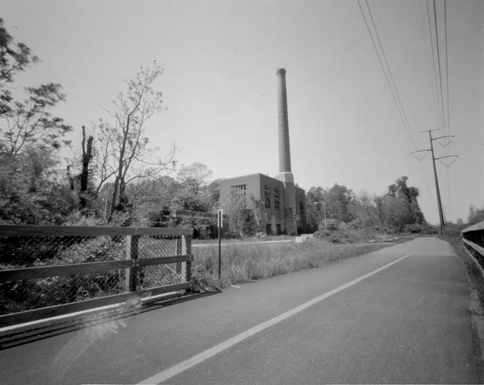

Armed with a short list of destinations, I sallied forth with my 4x5 "Pinhole Box" and two other cameras on what was undoubtedly the nicest weather I've ever seen on WPPD. But alas, I think I'm going to retitle it "Worldwide Comedy of Photographic Errors Day," but that's a shortcoming of my own; maybe I tried to do too many things. First up, I designed a folding wire-frame viewfinder to add to last year's camera, did all the calculations, etc. Ran way too short on time to hack it out of some 0.020 black anodized aluminum sheet, so I threw a fixed blob together out of glued up black mat board and attached it with two-sided tape. Turned out to be a good idea. The angle of view on this camera is so-o-o-o wide, a wire-frame finder - at least my design - is about useless. Maybe a tube or ring and post rifle style sight for the center would be more useful.

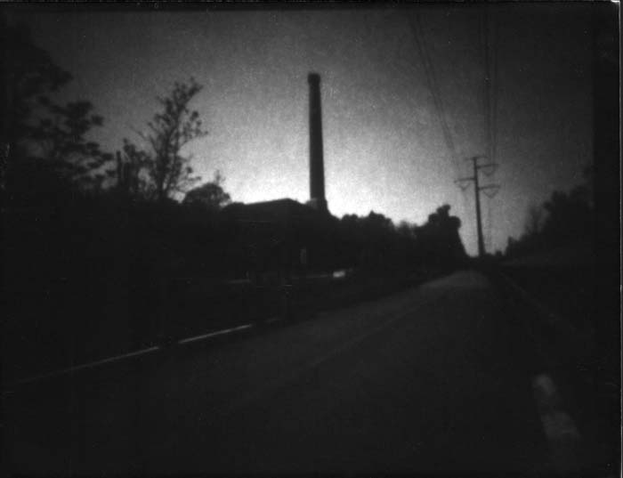

Among other "happenings," I loaded four film holders with Arista RC grade 2 paper, pre-flashed them a bit more than last year, based on a new test. I added those to a holder still loaded from last year. So of the three shots I took on paper, two were on a holder in which I somehow loaded the emulsion against the septum, since verified the only two with a screwed up load.
A negative:
But scanned and inverted, there's a bit more than I thought at first - considering it's probably 3 or 4 stops underexposed and the detail is diffused through the paper! - but definitely a downer. :sad:
On film it was more like:
That is a former power plant for Pennhurst State School & Hospital outside Spring City, PA. It was one of several such places closed in the 1980s after a decade of controversy, lawsuits, and exposure of things that "should never happen." The shots are taken from the Schuylkill River Trail, a former Pennsylvania RR right-of-way that used to bring coal to the plant.
With printed sticky labels bearing similar markings (both my film and paper were Arista), I managed to shoot two "paper" exposures - 25 or 30 seconds - on film that should have been about 5 or 6. The reciprocity gods worked in my favor (I mean, at worst it's less than 3 stops over), I pulled development of those two sheets a little bit and they are fine.
Several of my destinations proved to be posted no trespassing, or buried in jungle to the extent they were adjudged not worth the effort. But I got a few shots, sent in this one:
That's a crane made by Phoenix Iron Company in Phoenixville, PA, still standing in the remains of some sort of railroad facility in Boyertown, PA. I also went through a roll of Acros in the Bronica for what I hope will be a near-abstract study series of this rusty metal. The negatives look good -- we shall see. Have a couple of shots to finish another roll in the Bronica started at that power plant.
(Maybe I should go for 8x10 in 2013.)

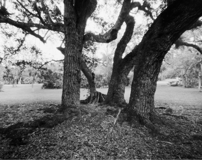

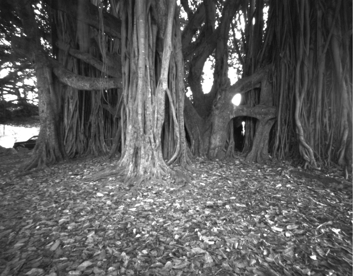

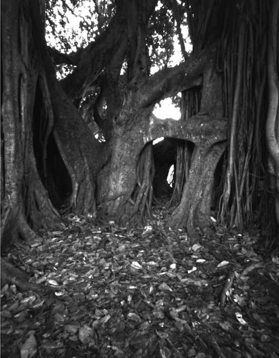

Results from my first attempt with the Ilford Titan. Shot Saturday beating the all day rain showers we had Sunday. Ilford HP5 metered with my old Gossen Luna Pro and the Ilford exposure calculator and developed in ID 11 1:1.
This is fun!
http://www.jeffreyglasser.com/
Slight correction metered with my Ultra Pro the Luna Pro stayed home.
Assuming corrections were minimal, if any, the metering is very good indeed, but it's the subject matter that is of the most interest and gets these atmospheric images over the line with more WOW! factor in them. I am especially smitten by the first one. And of course it's fun! Every day should be pinhole day. I'm taking 'Zero' out for a walk later today to finish the roll in it.

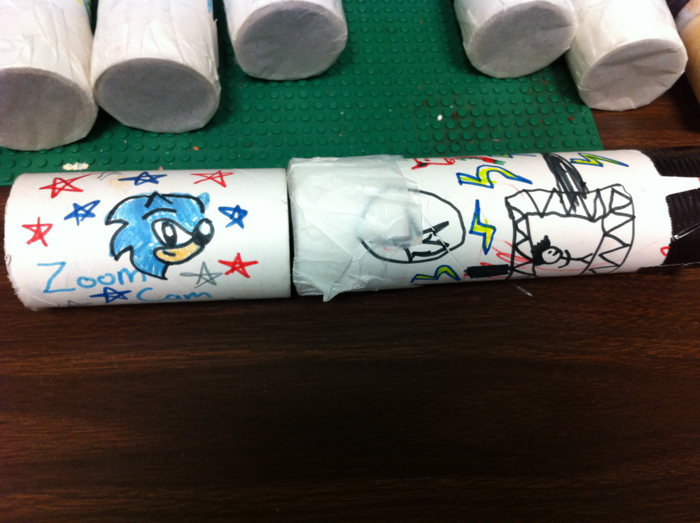

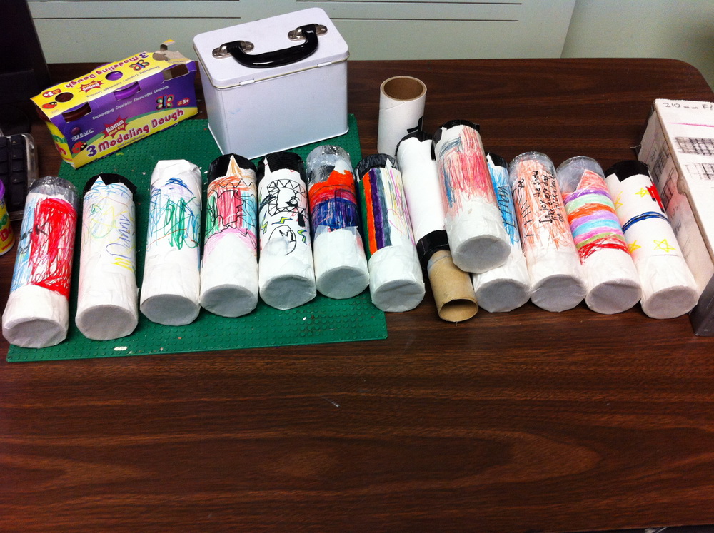

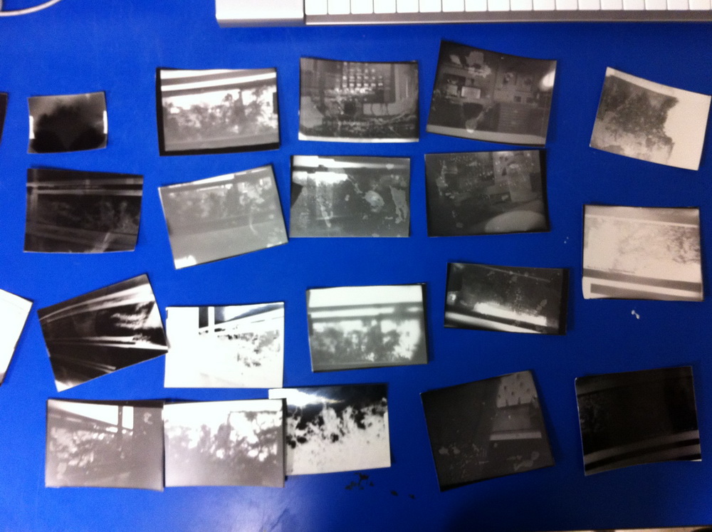

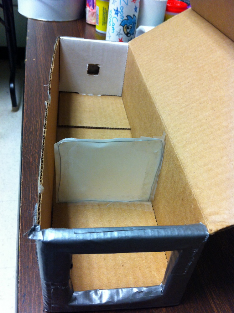

My students got to shoot a bit with their pinholes today, we had them loaded up last Thursday ~9-10 metal tins but didnt get to use them until today (Friday I have off now, and Monday was Photoshop and Flash animation classes). Guesstimate exposures ~3-4 minutes each.
We did about 20 or so of them plus some quick contact prints, there were more I didnt take a picture of. I have to actually rescan these but heres a bad pic lol.
They had lots of fun taking pictures of things out the window and around the classroom (like 10minute exposures).
Bonus: Ive included some pics of the Camera Obscuras they made the week before in prep for pinhole cameras.
The tube camera obscuras work with a 2nd smaller hollow end piece to cup over the tracing paper to act as a shade/darkcloth. The long box camera obscura has a piece of mylar suspended in the rear, its designed to be opened and closed to show students the path of light, and works very well too. You only need to cup your hands around the rear to see as well so no heavy darkcloths needed! The white tin in the back is what we used to make the Pinhole pictures with (we had a bunch of them).
