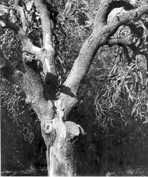

Let's have some feedback
Hello again,
Attached is a detail of a scan of a straight print of a neg of a film test on 2006 FP4 developed in Rodinal for 20 min with initial agitation and again at 10 min. The print was done @ grade 1.5 for 14 sec. I am trying to find out if this film can still be used. The dark patch at the middle of the print metered at zone 3 while the murky woods at bottom right metered at zone 4. Although they were murky to the eys, I don't like the way they print.
Any advice is helpful
