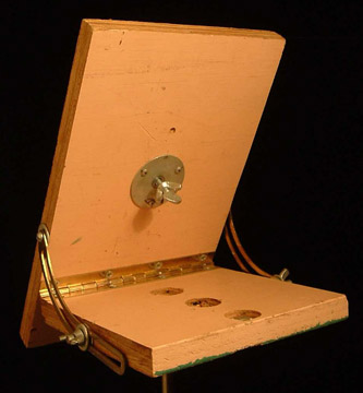

. . . Also, most often I am tilting down with my 8x10. Has anyone come up with an alternative to the Reis-style head that would allow tilt and attaches to a surveryor's legset?
Neal
A type of tilting head that was popular long ago can be improvised from scrap plywood and hardware store items. A section of piano hinge and two modified lid supports make it rigid and strong. The tripod socket screw is held captive by a stop nut retained between two fender washers epoxied or screwed to the tilting plywood. The upper washer is inletted to provide a level surface to support the camera. The lid supports are clamped by wingnuts on threaded rods that are epoxied into tapped holes in the bottom plywood. Two T-nuts are inletted into the bottom plywood for balancing options. The screws on which the lid supports pivot must be a snug fit. This version tilts 90 degrees. If less tilt will ever be required, the lid supports can be mounted further from the hinge, and reversed so they don't protrude.
