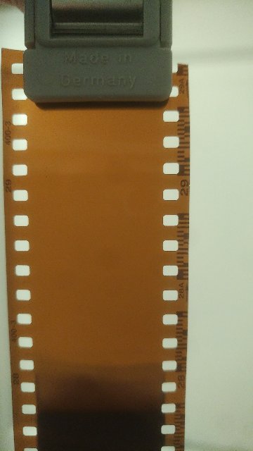

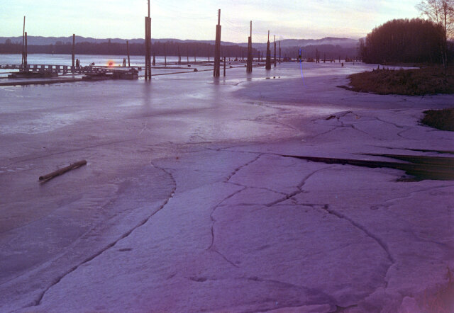

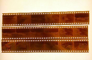

so there i went with my usual routine, but I got very psychedelic results:
overview of the whole strip:
crazy
1st frame:
2nd frame:
3rd frame:

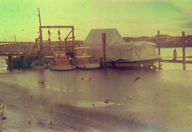

the 10th:

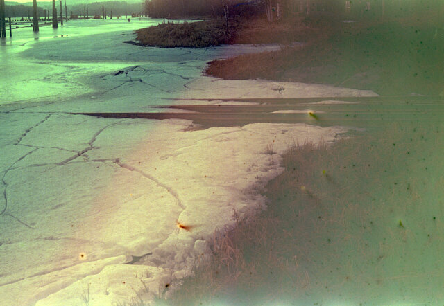

the 14th better but still these dark points:
so I was scratching my head. Never seen this. Only fails I have ever experienced were colour shifts when trying to squeeze yet another roll out of overused chemicals, ie. exhaustion.

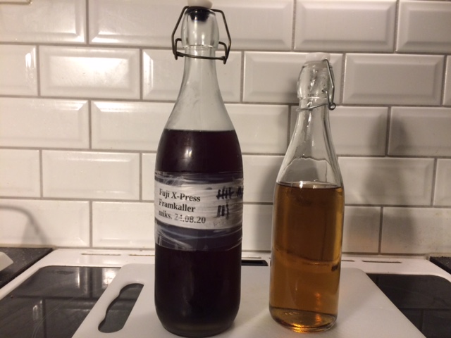

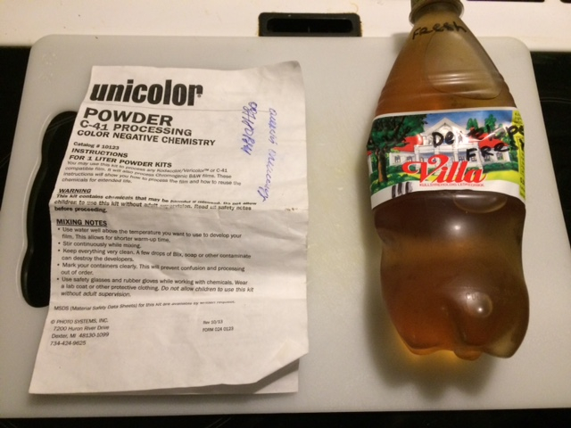

here, to the left a bottle of Fuji X-Press used 17 times, to the right the Unicolor I just used, and it looks fresh and without precipitates:
the Fuji X-press is still strong, so what was the problem with the Unicolor ?
and no, the bleach and fixer are ok, so it was the developer ... or the development.
that's when I had a look at the Unicolor instructions sheet, and it says.

The different agitation scheme does not explain the different results. Looking at th initial series of photos, it seems you have a variety of defects and problems occurring at the same time.
I wouldn't know where to begin troubleshooting this given the systematic overuse (abuse) of developer. All bets are off when trying to extend the lifetime of a c41 developer beyond any reasonable limit.

There's just no way that the difference is due to the difference in agitation schemes.. How does the negatives look from the first roll? What film was it? Was it expired?

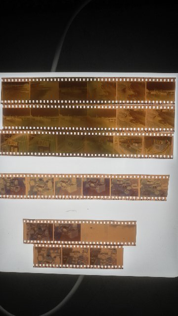

it's the same roll of Lomography-400, of a 3-boks pack with expiration 07/2020. I took 17 shots, then cut and develop with the fresh Unicolor. After seeing the result, I did shot and develop another 6 frames with my good current developer (the Fuji) and these are good. Then I shoot the remaining of the roll and develop again with the Unicolor, but with the agitation times of the notice coming with it.
the boks:

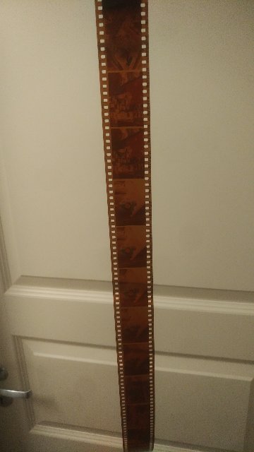

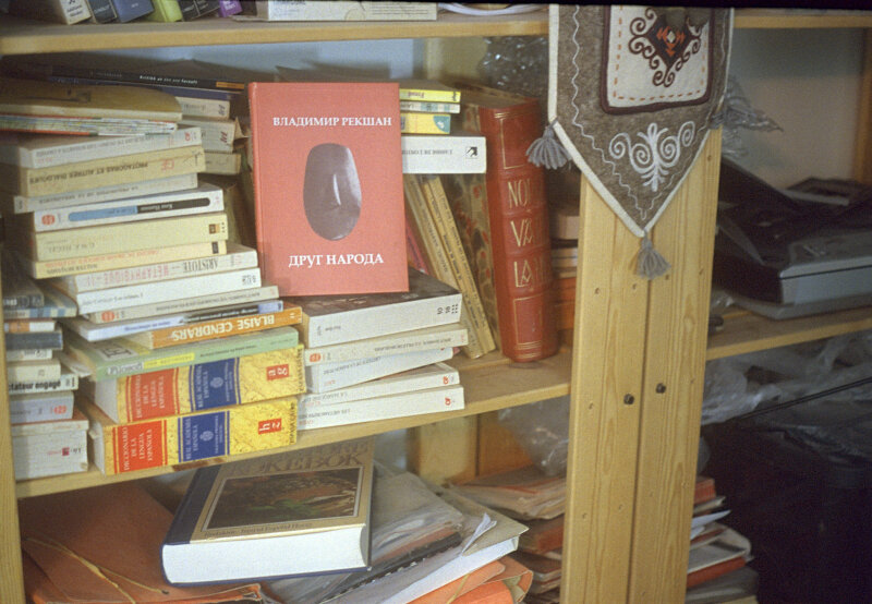

the whole roll (minus unused blank ones at head and tail):
the 3 first strips are the bad ones, with Unicolor dev but with Fuji X-Press agitation (Fuji is my usual developer)
the 4th strip is with the Fuji developer and is good
the last 3 strips are with the Unicolor again, but this time only difference is agitation times, as per the Unicolor instructions that I didn't read before.
only the 3 first, bad ones:
I totally agree that the bad first 3 strips are totally cuckoo, and I was left puzzled.
the only alternative I see is that there was something else in the tank/water, yet water was fresh, development sink was rinsed, tank was clean ....

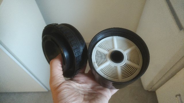

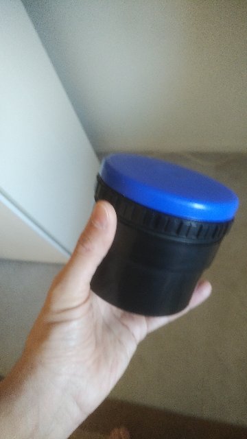

what I am suspecting now is the tank. A compact AP that was part of a set i bought couple days earlier from yet someone else who tried home development, didn't get hooked and sold all very cheap: changing bag, digital thermometer, squeegee, hanging clips, tank, and Adox (BW) chemicals (almost full bottles of Rodinal, Adoxfixer, Adoflo). Means he had used the tank with BW development. It did look clean, yet I rinsed it before use. But who knows there may have been small sticky remains of whatever, that were loosened with the 1st run of Unicolor, and no longer there for the 2nd run.

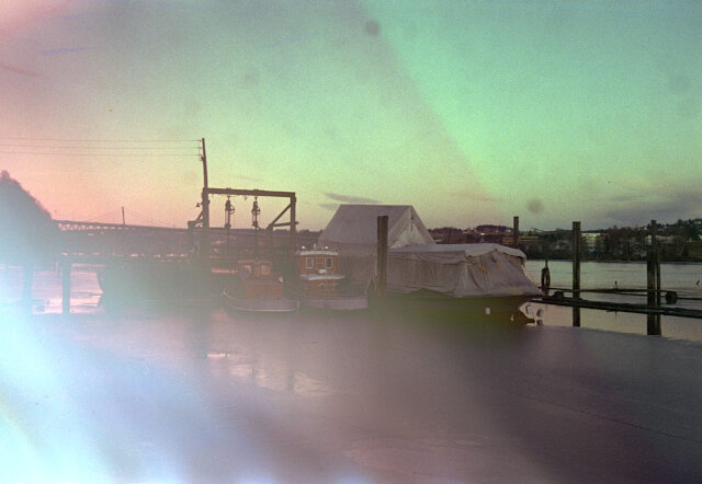

The density of the rebate on the “bad” images is not consistent. Could there be a light leak somewhere in your process.
removedacct2
May 26, 2018
366
not one I can think of.... it was the first time I used that tank, but it's an easy one, the top is screwed down until it is thigh and there's a strong gasket pressed in the end, the thread of the lock is thick enough, you can't screw if it's askew.
yes it looks like a festival of all kind of fails possible included light leaks, all gathered across a single strip of film...
i thought for some of these defects, of light leaks and pin holes in the curtain of the camera, but I used it recently without issues, and checked the curtain again closely with a lamp and it looks good.

The "waves" of greenish fog on those negatives look a lot like what I got last weekend when i loaded two 120 rolls end to end, processed in replenished Flexicolor, and agitated by "swizzle stick" rather than inversion (which I've been doing trying to limit oxygen exposure of the developer). One roll shifted in the groove and wound up overlapping the other by about 50% (or else I did a really, really bad job pushing the first roll to the center before starting the second -- pretty sure that's not the case, I've done this many times with good success, even in swizzle stick processing -- but I'll be trying inversion from now on, and watching to see if that affects the developer).
I got images in all frames, but the overlapped frames on one roll (the on where the overlap was on the emulsion side) came out of the tank with fixer residue and retained silver; after rebleaching and refixing (with fresh fixer, due to a bottle swap that got 300 ml of color developer into the fixer storage bottle), that residue was gone, but there was evidence of incomplete development and/or fogging in the same area, in the form of a green "haze" that scanned as reddish/yellow. I'd have said it was a light leak, except it was the exact same area that had the silver retention and fixer residue.
Is there any possibility you could have had a loading problem with that new-to-you tank and reel set, leading to insufficient space between layers?
removedacct2
May 26, 2018
366

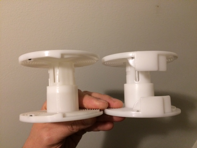

the tank only is new, not the spiral, the opposite: it's an AP spiral. For colour with the short C41 dev time, I use Paterson plastic tanks because they load/unload much faster than steel ones. . But the Paterson spirals are a PITA often, so the couple i have are never used, instead bought long ago few AP ones.( For BW I use Kinderman like steel spirals and tanks.)
See left the damn Paterson, right the AP. In this case it was the AP in 35mm that came with the tank:
BUT you are right, I may have squeezed two spires into one track when loading the strip without noticing because the strip is short (17 frames)...

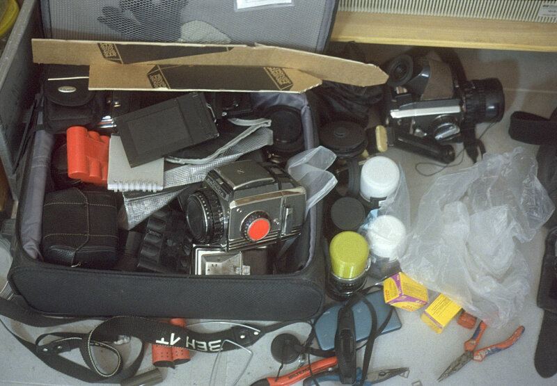

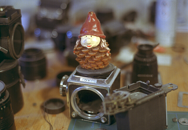

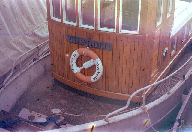

anyway, I wanted to be sure the Zorki I used with the industar-61, when I took the "bad" shots are both ok. These outdoors pictures were taken with cloudy late evening sky. For this test this night I have put couple 12.000lm 5500k lamps in the room, loaded the same film (Lomography-400) and shot few frames. Developed in another run of the same Unicolor. I have just scanned and it's all ok:
few frames:
