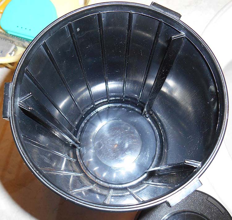

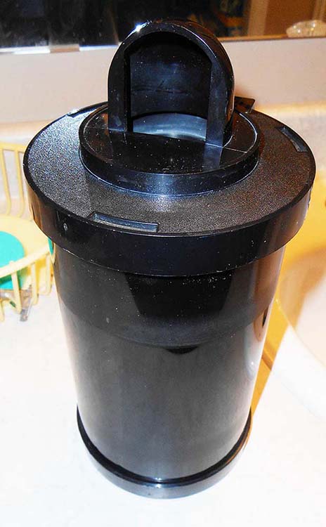

Here are some pictures of the drum. What are the procedures on using it and developing? For 4x5, 5x7, and 8x10 sheets?

With the internal ribs inside the drum, is there any chance of scratching the 8x10 sheet, especially when trying to remove it out of the drum?
Also just a note for me- when feeling for the notches on the upper right side of the sheet, the emulsion side would be facing you- correct?
And with the drum- how fast would you roll it on the floor while developing film? And you keep rolling it for the entire duration I take it?
With the drum I have, does the 4x5 sheet site sideways or vertically in the slots in the drum?

The drums I'm familiar with are for prints, not mainly for film. Some people use them for negatives, however. Print drums are usually smooth inside, from what I've seen/read (haven't yet gotten the one I ordered).
Edit: okay, went back and looked at the photo. Those ribs are to let the solutions get under the sheet, and that drum is meant for film. You shouldn't have a big problem with base side scratches in that drum design. The larger V-shaped rib is to separate two sheets.

Donald- do the 4x5 sheets sit sideways in the slots or vertically? And would I use the slots for 8x10 or just slide it in anywhere?
MattKing
Apr 24, 2005
55,143
Delta, BC Canada
Try cutting some paper to the exact size of a sheet of 8x10 and experiment tin the light.
If you have developed 4x5 negatives, use them.
The ribs are there to hold the sheets in position.

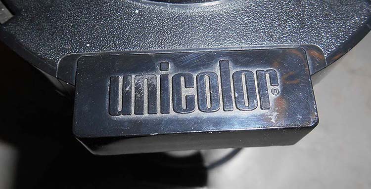

SO I tried developing my first 8x10 sheet in a unicolor paper drum. Most of the developer leaked out within a couple minutes. Where can I get a replacement gasket for this unit? I obviously cant use it till its fixed.
braxus
braxus
Oct 19, 2005
1,831
Fraser Valley B.C. Canada
I heated up the plastic gasket to try and refitt it into the lid. Ended up melting it. So now I need a plastic gasket as well. I don't see any sources for this either.
