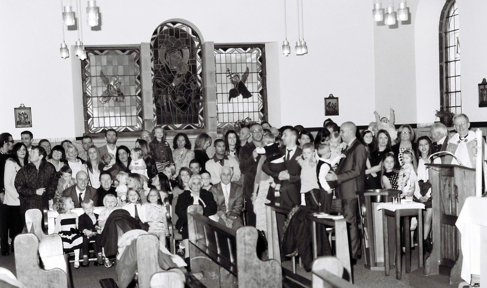

OK, well that's re-assuring, and yes I will post the results when I get them.
As for recycle time - I put brand new batteries in it this morning and it took 4 or 5 seconds to recycle, so I think it was maxing out. I don't recall a beeping sound but that's not to say it didn't make one.
However, in my panic, I had the flash set only to f8 - likewise with the lens which was set to f8 @ 1\125th (EV13). According to the dial, the maximum range is about 15 feet and I assume that's head on - I suspect it is more like 10 when bounced (though WillTW above says the flash compensates for that?)?

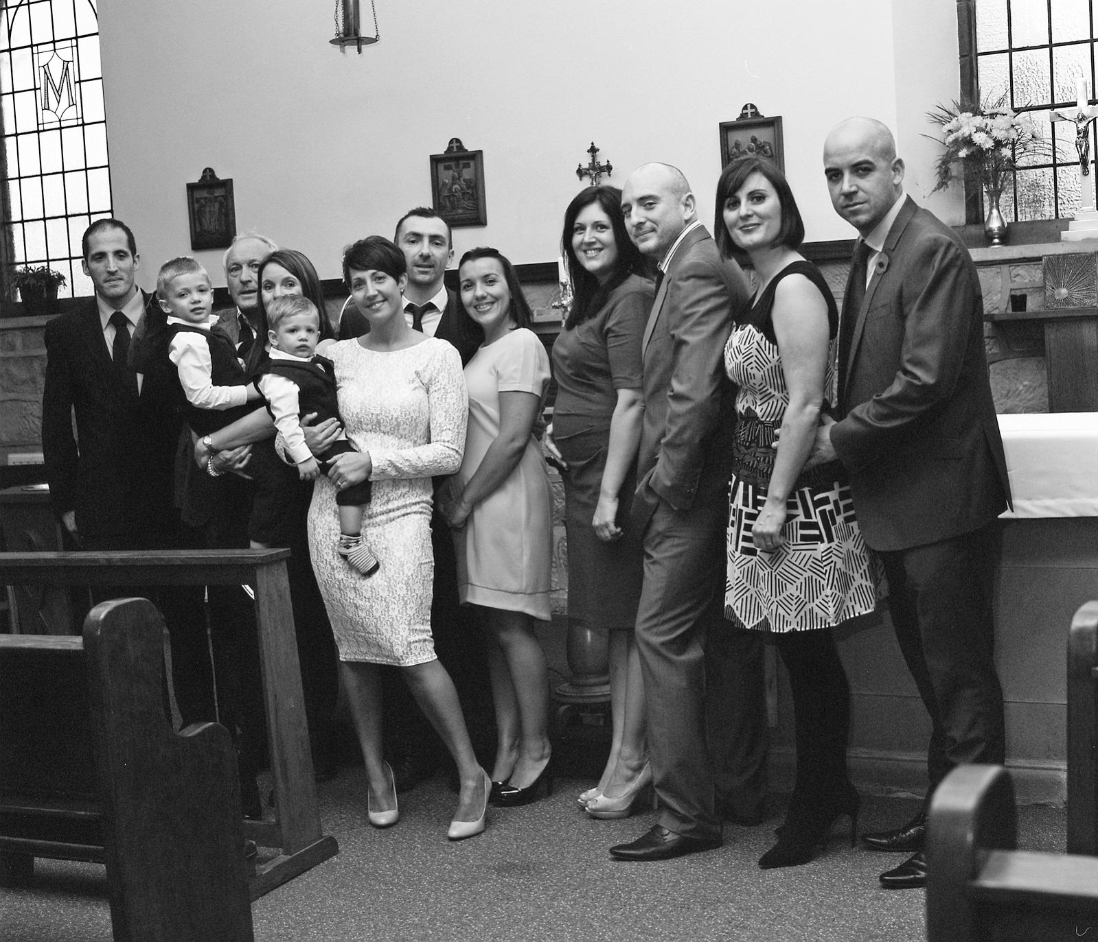

OK, the results are in!
Better than I expected, but not as good I was originally hoping for. Enough as a keeps sake for my friend though!
But thanks guys - I wouldn't have got this without you all. It is appreciated.
