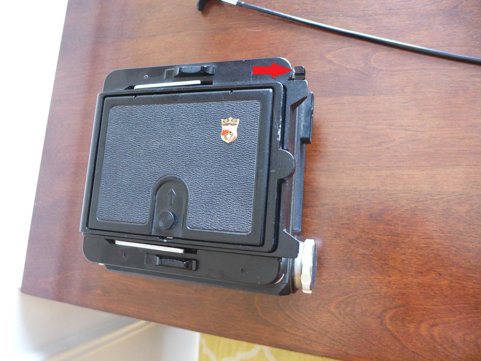

I have recently acquired a 45N that I am trying to acclimate myself to. I have two questions that I would appreciate help with, if you know the answer:
1) What is the best lubricant for the rear swing? It is really stiff. I tried some silicon, but it only helped a little. It seems to be metal on metal, so I am wondering if I should use mechanical grease.
2) What is this switch for on the rotating spring back? I took the back off, and cannot see it affecting anything. You press it upwards, but nothing happens that I can see. I have looked at the manual from Butkus, and I can see this lever on the photos, but the manual never mentions its function:

Thanks John - I thought grease might be the ticket. I'm not sure that lever is for the rotating back. Mine rotates fine without it, and it just "seats" into place. I don't see a lock, or how that lever would lock it. They are old, though, so maybe mine is missing something.

The button with the "up" arrow should allow the panel that it is located on to swing up, it's probably a pop-up mini dark hood (at least that is what my Toyo 45 AR does with a similar catch).
If you mean the 2 long rectangular tabs (one on top and one on bottom) those should allow you to slide part of the back to remove it, to expose Graflok mounting slides. Removing this should help you identify where you are having friction problems, as it makes more of the mechanism visible.

I put a red arrow showing the lever I'm talking about. It's not the hood release or tabs for removing the back...
