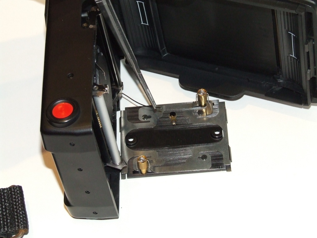

I love this stuff. Buying something that is listed for much less than other similar items. There is some risk, but that is the excitement. In this case a 6008i for hundreds less than similarly listed items. Near mint condition with some secret hidden flaw. In this case I found it right away. The film did not fully wind up after the last exposure. A quick inspection of the pressure plate revealed the sensor-wire had broken off near the solder joint. An easy fix!
It is odd to find this in a near-mint specimen with no signs of tampering. Perhaps a QC issue. If anyone has a 6008i that does not wind up the film after the last exposure, check the little wire. You can see it without taking the pressure plate off, just look in from the side.

Thank you for the information on the fix.
Unfortunately I have to say that gamble is so not worth it. I'm glad it worked out for you but as an owner of a Rollei 6008i I can't imagine what I would do if my camera went on the fritz. If I determined it was a fault with the body and not the magazine as was the case with you I would sell the malfunctioning body and get a working one. Seriously you only need that gamble to fail once to wipe out the profits from numerous previous purchases. A price way outside the norm is usually a big red flag. Not always but a lot.
