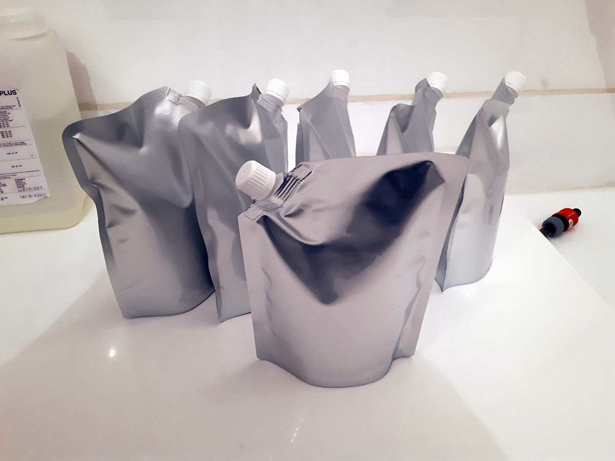

freshly mixed Xtol. My 'goonbags' held about 900ml full so I ended up using 5 & 1/2. I'll label with the date and put one away for a year or so :D
