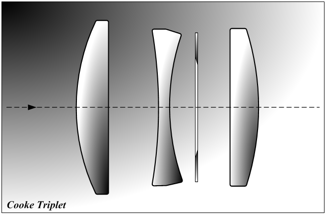

The Epis series, like most episcope lenses, is a Cooke triplet design. Usually in these (like also the TTH Cooke Series II), the aperture is positioned close to the negative center element, on its rear side. That's also true in descendents of the triplet design which have doublets for the front and/or back positives (Heliar, Saphir etc.).
Triplet designs are in general not completely symmetrical, and they are calculated in a way that the negative center element is slightly stronger than the front positive, so the beam is slightly diverging behind the center element.

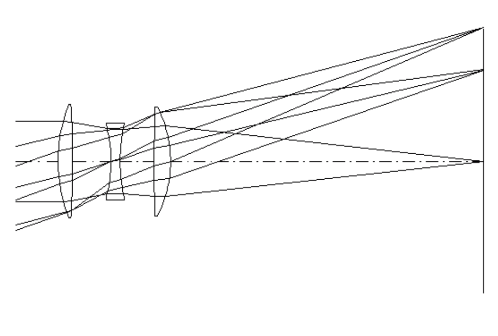

Apertures are usually placed in the optical center of a lens, i.e. the point where the chief rays of all pencils of rays intersect. Doing it this way makes so that every pencil of rays is affected the same way by the aperture (and it doesn't cause vignetting). Placing the aperture outside the optical center usually isn't very much of a problem though. You will have two effects: introduce vignetting in pencils that come in from the extremest angles, and for out-of-focus objects "moving the cutout of the bokeh ball inwards or outwards from the axis", therefore affecting the distortion characteristics of the lens.
When only having the aperture slightly off center (i.e.: directly behind the negative element), the effect will be minimal. Historically though, aperture positioning has in fact been used artistically (cf.: Eder, Ausführliches Handbuch der Photographie 1,4: Die photographischen Objektive. - chapters on the simple lens and the Petzval).

- the argument that "the opens we make in the waterhouse stops may not be accurate given the calculations we make" is bs. Simply write down a ray transfer matrix analysis for that system. I.e.: Measure the focal length of the front element and the negative middle element roughly, the distance between front and middle, and the distance between middle and desired aperture position. Simplify the system matrix as: (free propagation between middle element and aperture)*(middle element as thin lens)*(free propagation between front and middle element)*(front element as thin lens). Then you're inputting a ray of (x0, 0), calculating what the x1 at the aperture is. Then plug in an aperture number N=f/x0 into that, and you find an equation for x1 (in terms of a diameter then) at any aperture number N. Not hard, just half an hour of actually writing down the math.
You could also simplify further, using just (free propagation between front and middle element)*(front element as thin lens) as matrix (would save you the hassle of measuring the negative element).
