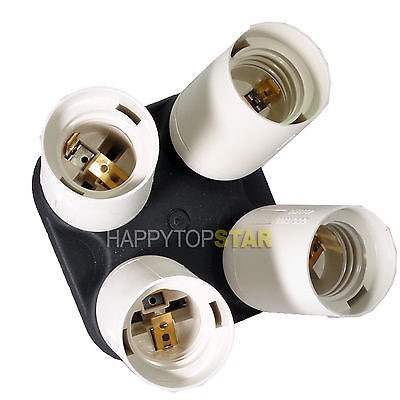

What do you think about this four light setup with the little black lights ?
http://www.ebay.com/itm/4in1-Studio...g=20140407115239&rk=21&rkt=30&sd=230531100461
For the price of the fixture and the cost of the bulbs, you can hardly lose! Tho that face-tanner nsurit linked to looks pretty nifty!
