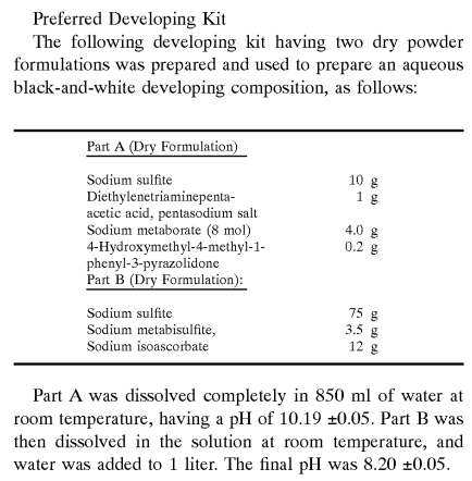

Yes, I am on it right now. Also, it's important to know, if the formula is asking for DTPA-Na5 1gram and not DTPA free acid as I thought at the beginning, maybe it's in fact DTPA-Na5 40% solution? @albada maybe can tell us more.
Here are what my notes say about the old name+formula and new name+formula of the sodium metaborate that XTOL specifies:
OLD: Sodium metaborate octahydrate, Na2B2O4*8H2O
NEW: Sodium metaborate tetrahydrate, NaBO2*4H2O
Other names: Sodium metaborate 8 Mol, Kodalk
CAS: 10555-76-7 (MW = 137.88)
BTW, the XTOL patent specifies 1 g of DTPA*5Na for its "Dry Formulation", so that weight is for the dry powder and not a solution.
For your reference, here is a screenshot of the formula in the patent:

Thanks, man! I thought it should be a dry powder, not solution. I also found @Nikola Dulgiarov post about metaborate substitution and finally I adapted the formula like bellow, after I substituted also the sodium ascorbate with ascorbic acid (highly available at low prices where I live)
Water ........................... 750ml
Sodium sulfite ........ 89.65 g
DTPA-Na5 dry .................. 1g || DTPA-Na5 40% sol .... 2.5 g
Borax ............................... 2.8 g
Sodium Hydroxide .. 1.59 g
Ascorbic acid .......... 10.67 g
Dimezone-S ................. 0.2 g
Water to 1L
Water to 1L
Something else from my notes from 10 years ago:
1 gram of ascorbic acid can be neutralized by 0.477 g of sodium bicarbonate. Add these two to the beaker first, wait for the bubbling to nearly stop, and then add the other chemicals.​
Elsewhere in my notes:
12 g sodium isoascorbate = 10.7g ascorbic acid + 2.4g sodium hydroxide​
2.4 differs from your 1.59 g, so that calculation is worth rechecking.
I dislike sodium hydroxide because it's so hygroscopic that it gains weight while I'm weighing it! Furthermore, I don't know how much water has been absorbed into the powder in the bottle during storage. Thus, I cannot weigh it accurately. S. bicarb doesn't have this weight-gain problem.
Mark

Here is a link to a post of mine from this thread but few days ago that explains with a table how I did the calculations.
https://www.photrio.com/forum/threads/will-the-real-mytol-please-stand-up.84293/post-2765081
That 1.59g is the result of three weights of NaOH operation which are resulting from metaborate subtitution, isoascorbic substitution and metabisulfite substitution.
