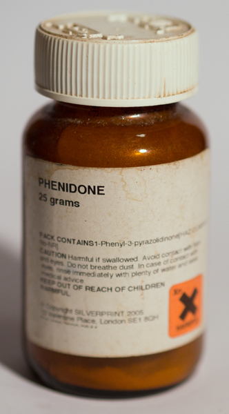

My phenidone in the UK from Silverprint is labelled 1-phenyl etc, ie,it is apparently Phenidone A.
yView attachment 190276
Maybe the phenidone powder sold to hobbyists was and is Phenidone A, at least in the UK, and that which used to be in proprietary developers Phenidone B.
Well this is the same very stable Phenidone that I've bought from 3different sources over the years, that keeps well in glass and plastic bottle/containers.
