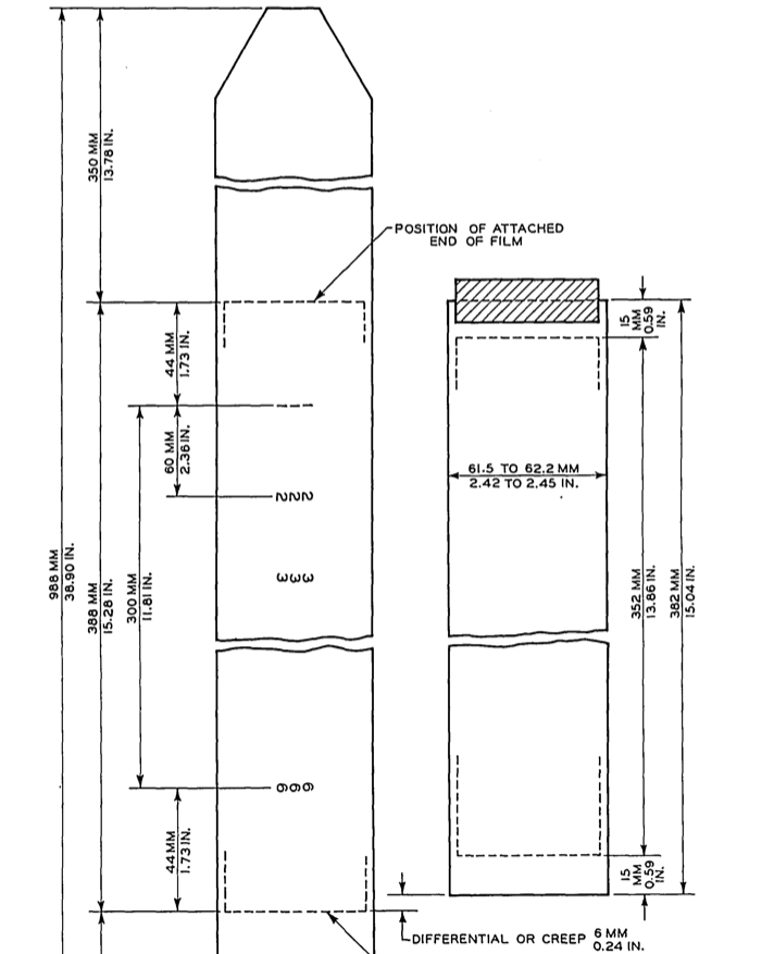

Don't know if this helps.

So much about the trustworthiness of an ISO document, stating in the text a figure that only is the lower limit.

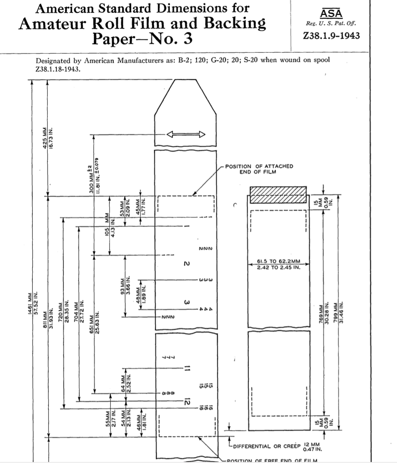

Here is a better image of the document; specifically the 120 section. This document is ASA, which is pre-ISO. I did not know of ISO732 but most of my 120 equipment was probably designed during the time this older ASA document was valid.

Interesting. I wonder why the acceptable width of 120 film has decreased so much. >1mm of difference across the tolerance range of the older standard and the latest ISO 732
