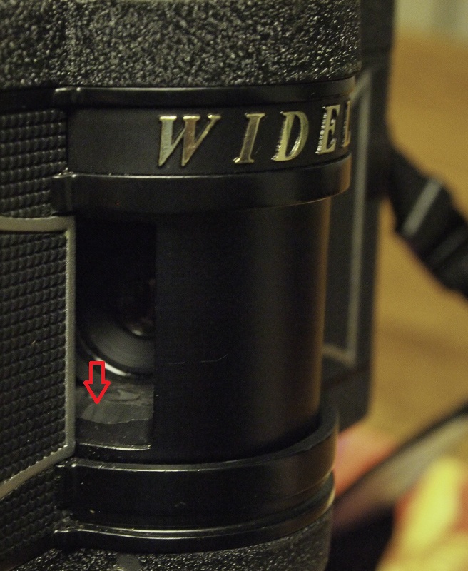

I have just bought a nice Widelux F8 on ebay. Fantastic cosmetic condition. It also seem to work fine - I have shot a test roll and cannot see any issues. However, when inspecting the lens I noticed that there is a piece of solid rubber or some other material stuck between the lens and and this panning part (not sure what's called in English). Picture attached. I contacted the seller - he said he has no idea about that rubber - it claims it was when he purchased the camera and had no issue ever. The seller has the perfect feedback, so I tend to believe. Question - is this an issue going forward? Could be that the lens was wobbly and this piece is supposed to keep it in place? I'd hate to part with this camera...

That piece of rubber does not belong there and I would ask myself why was it put there and may there be an issue behind it that could become a problem, which then might need me to fix something indeed.

is it loose or just jammed in there? You could gently remove it and see what happens. It is possible it is holding something in place that is loose and should be properly repaired.

It is not loose, it sits firmly there. I will probably not try to remove it myself - at least now it works fine and I am not very keep to discover "what happens" if I remove it :smile:. I guess I will follow the advise to contact a reputable repairman to get their opinion.

I owned one of these at one point, and that rubber thing was not in my camera. I would, however, shoot a test roll through it to see if there are any other problems with the camera. A common problem is banding, where the lens turret doesn't move at a steady rate and gives you a varied exposure across the frame.
Thanks all. The test roll was just fine. Bob from Precision camera suggested to continue shooting until I see any issues, no need for repair now.
