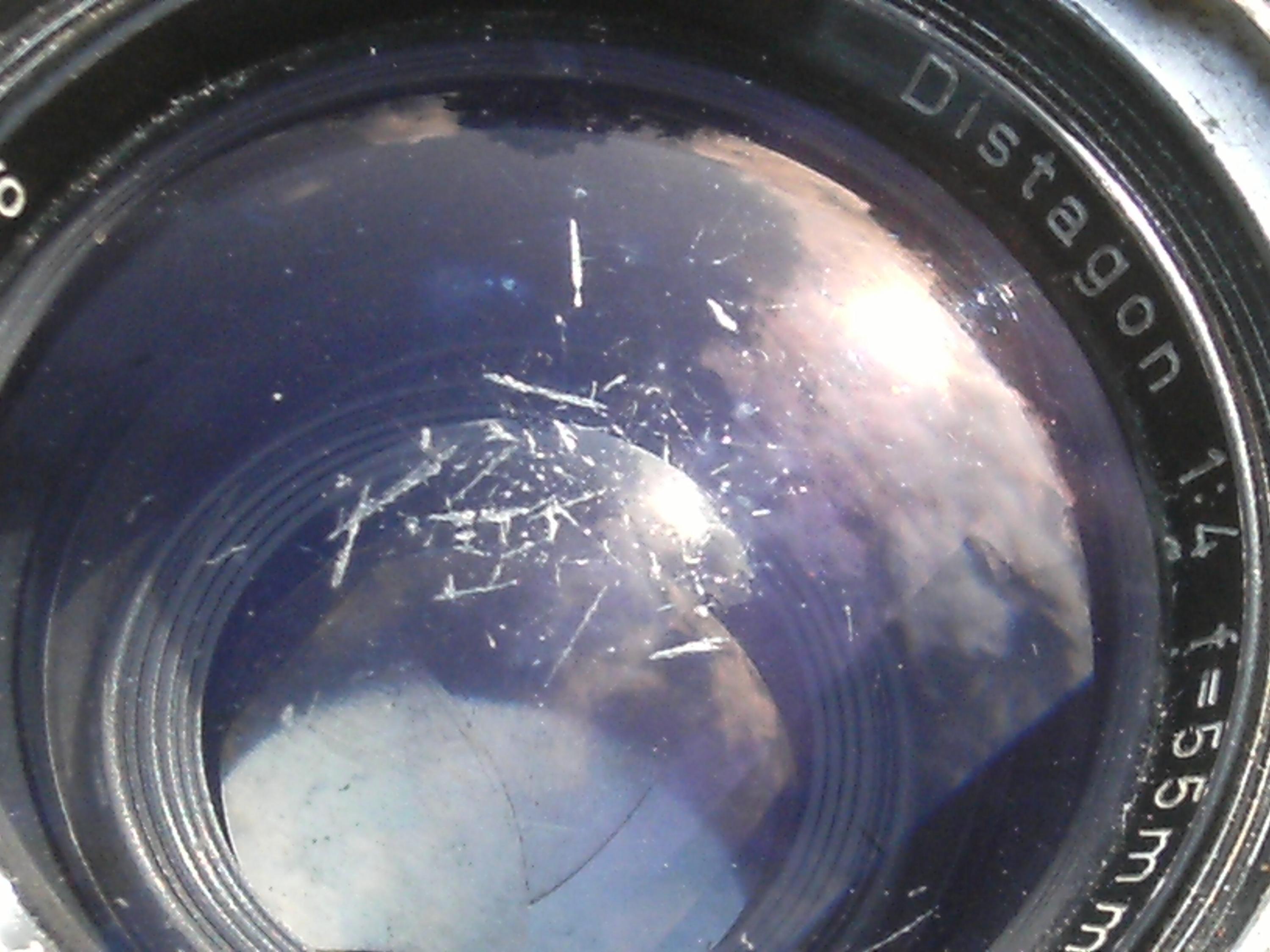

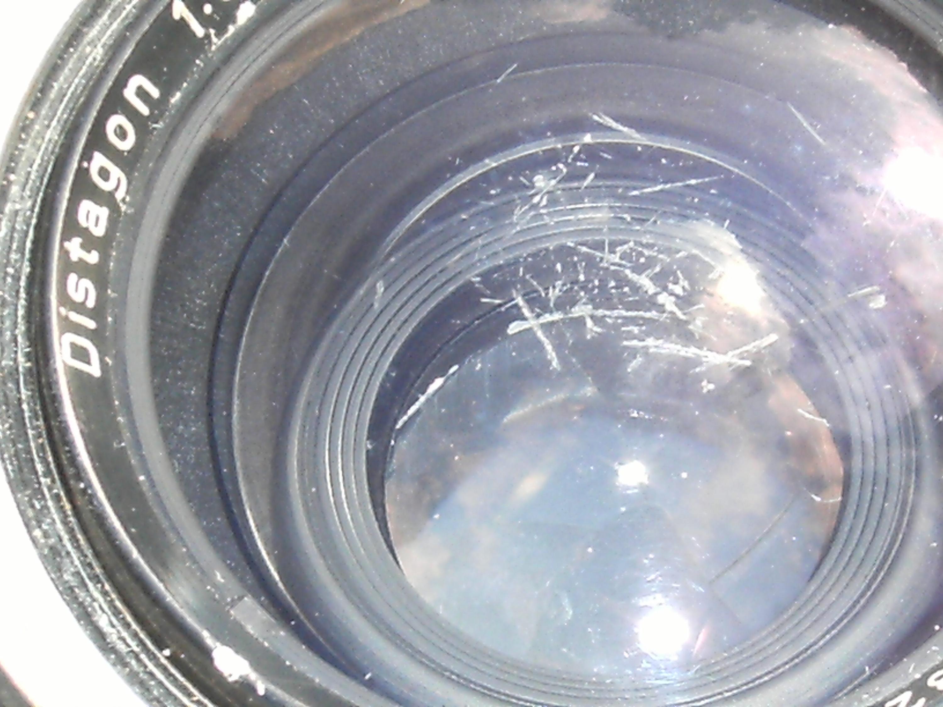

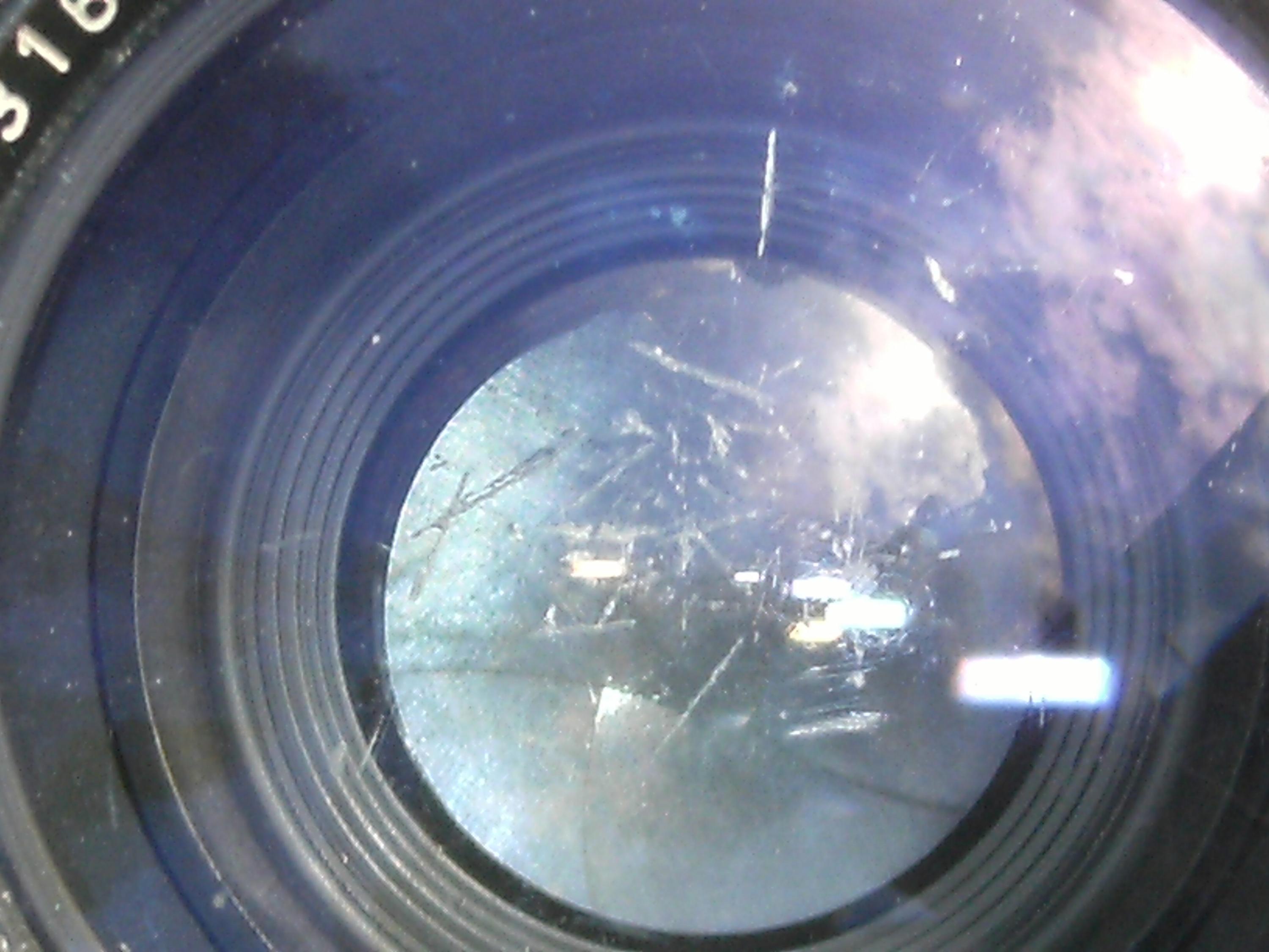

The Scratches ps Thanks for the link, Dan.

Those are pretty ugly but not beyond salvation. Strange as it might sound, I'd take a black fine-tip Sharpie to the scratches and fill them in. Get a lens shade for it, and use it. At this point, you got the camera for free, so what's the harm in trying? Look around APUG for an old classified ad/discussion thread Jim Galli had posted about a lens that was old, rare, and literally cracked all the way through. It still worked. The scratches on yours are ugly, and certainly harm resale value, but if you keep the sun out of the frame and have the front element well-shaded, you should still be able to make good images.

The Rolleiwide might be my favorite camera. Amazing glass. Paid a pretty penny for mine in top condition but no regrets. Seeing that lens makes me feel like I'm viewing crime scene photos. :smile:

That looked really nasty and very sad to see indeed!!!

In all probability, if you're not seeing anything on casual inspection of your negatives, the only impact those scratches will have is to lower contrast and make the lens more flare-prone when there's a light source in the frame. So carefully shade your lens and pay attention to the placement of the sun or any street lamp(s) in the scene and you'll be fine.

People ask about polishing and re-coating the lens on their point-and-shoot, and it is never worthwhile. However, it might be worth it to inquire about salvaging that front element.
http://www.focalpointlens.com/fp_services.html
That's not scratched, it's gouged. The rule of thumb is if you can feel it with your thumbnail it's beyond polishing.
I'd fill the scratches with India ink and hope for the best.
From Focal Point:" If a scratch is deep enough to feel with your fingernail, then it is probably too deep to repair".
