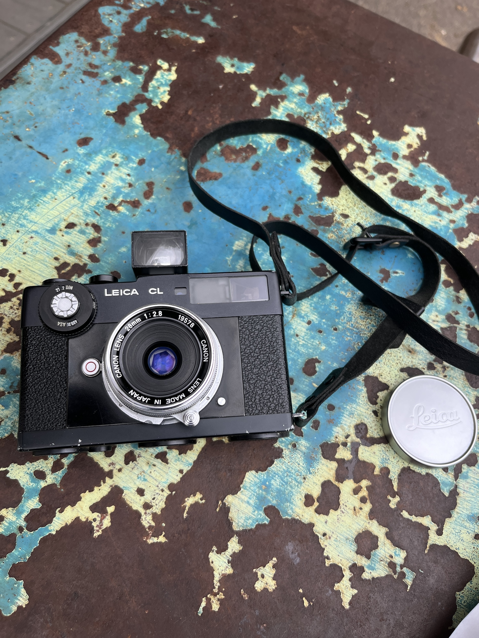

I have a Voigtlander 35mm f1.7 Ultron coming tomorrow so I can report back with a few pics on my digital
DavidClapp
Apr 29, 2015
186
England
I have my eye on that lens so I am interested
It was sold as perfect / no haze / no fungus and it had haze. I’ve only ever had two lenses in my possession and they both had haze, the most recent was the better of the two.
With all the countless ‘haze’ issues with the f1.7 I’m going to steer clear and maybe get a Canon 35mm f1.8 or f2
