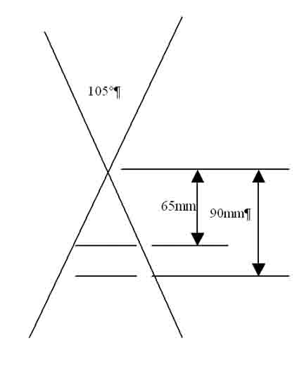

Heres a quick diagram of what is happening.
Yup. that's it. Maybe you should have made the film planes inside the cone two different colors? That way it is clearer what happens to the image on an equal surface (say a 4x5' film) at different distances from 'nodal point'. This way it is much clearer what Paul means by taking up 'less of the cone'. We should do this more often with diagrams, it's fun.
