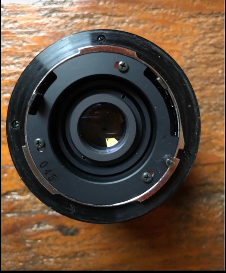

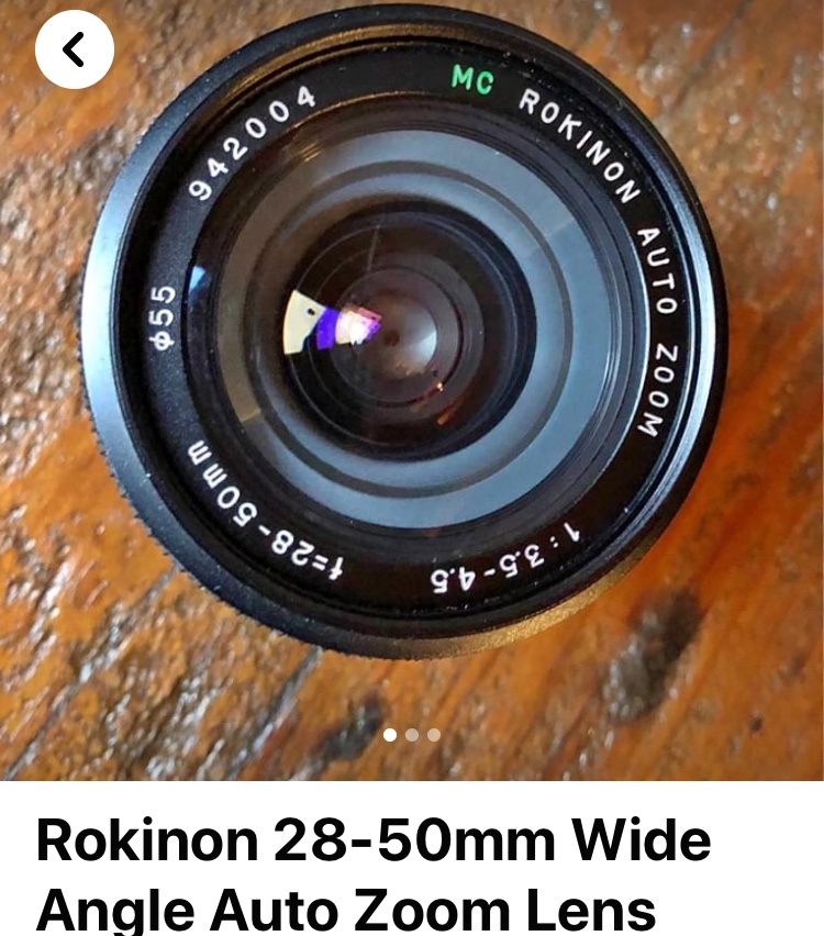

I have a nikon D3300 and I’m looking for an adapter to fit this rokinon lens, except that i dont know what type of mount it is. Do u guys know if it’s a konica or a Minolta? Thank you for your help :smile:
It's for Contax / Yashica. Don't bother trying to adapt it to a Nikon. You wouldn't be able to focus at infinity, or beyond a few meters, because the C/Y flange focal distance is 1 mm shorter than the Nikon. Find a lens that is native to the Nikon mount. I think on the D3300 you won't have any metering with a manual focus lens.
