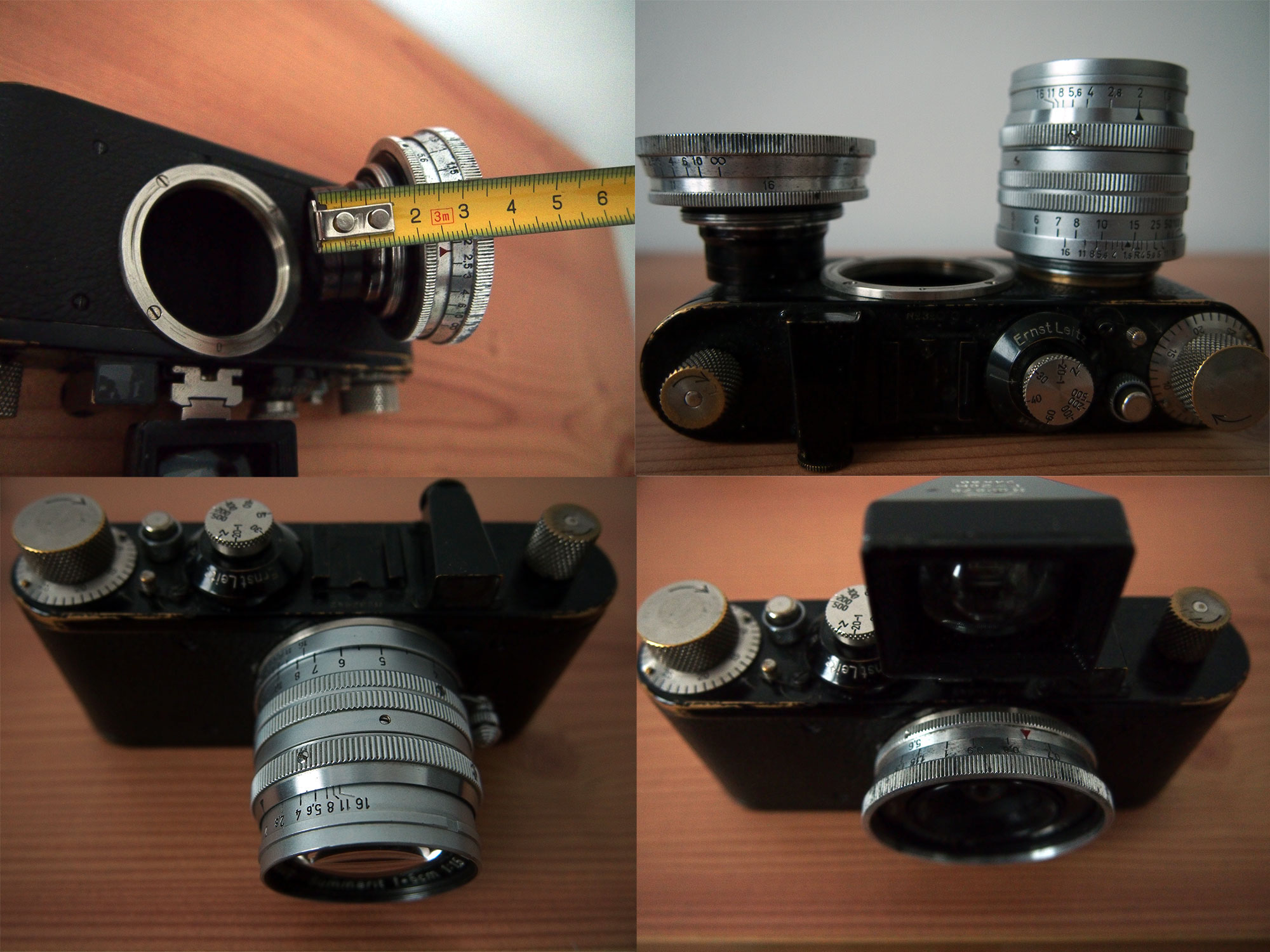

I apparently got a good one, and I have negatives from a prewar Biogon to compare with. My Arsenal 1961 Kiev mount J-12 performs like a coated prewar Biogon in this instance, I'm very pleased with it.:smile:

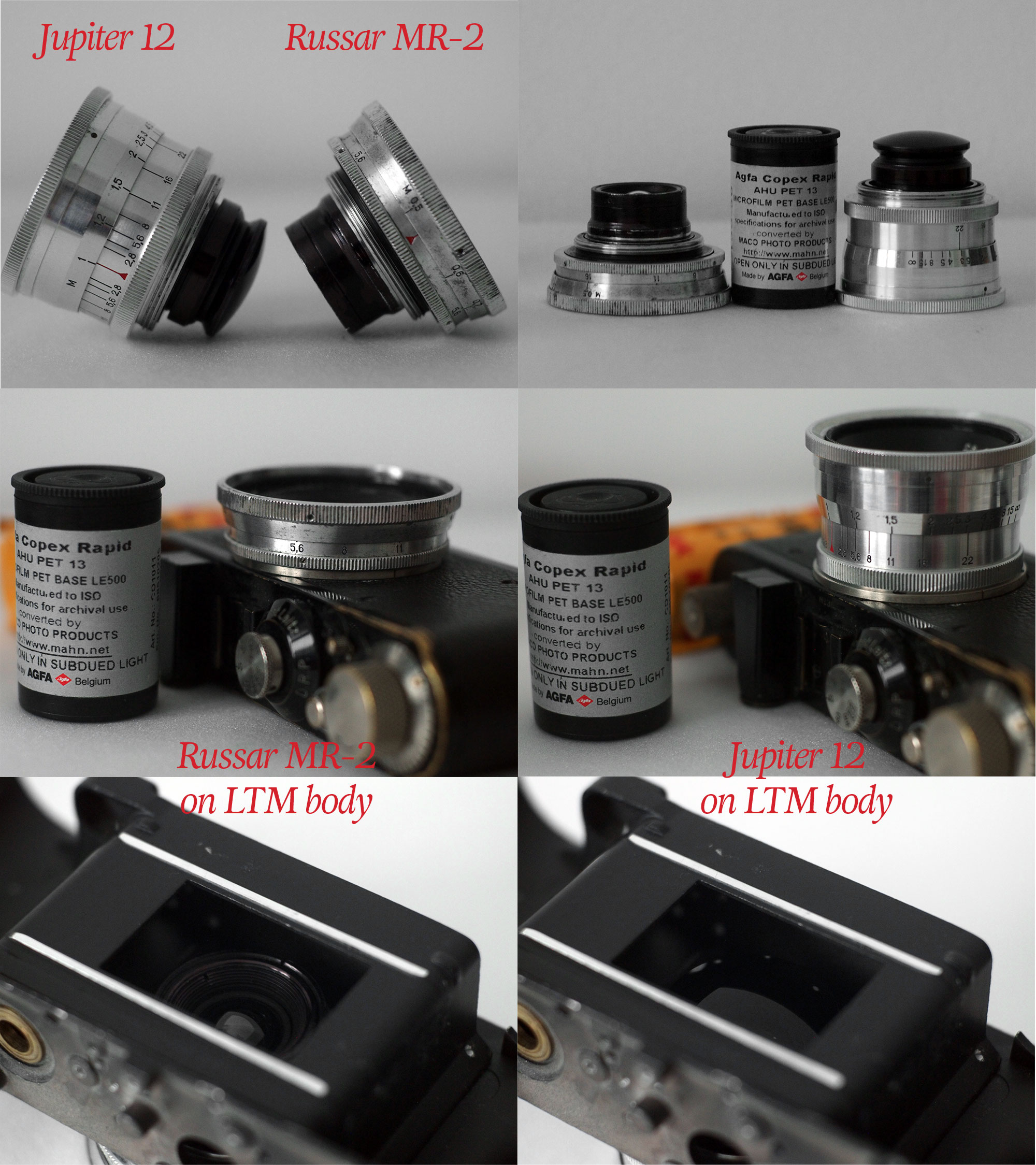

Here, I prepared something for the speculators, the ones who never even seen Russar MR-2, let alone shooting with it.
MR-2 versus a good ole 50mm.
Bon appetit!

Some more.

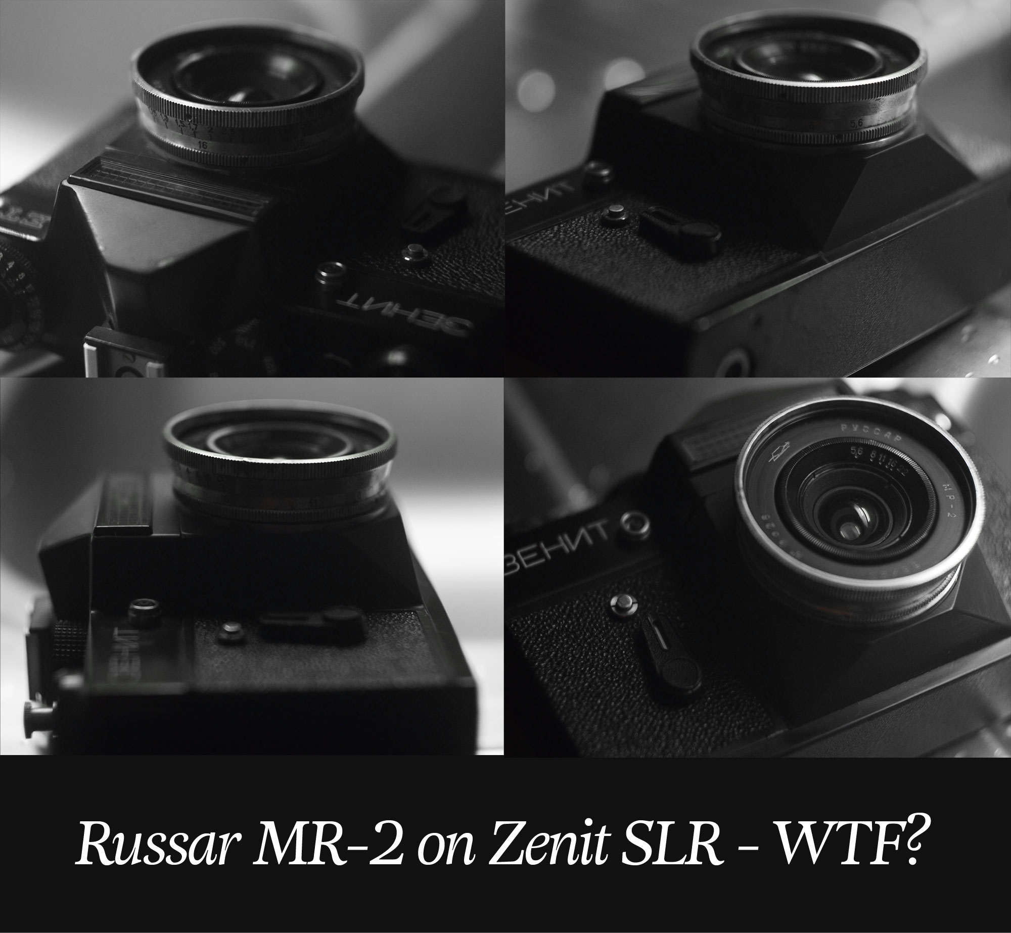

Huh, how big the Zenit was? :D
attachment.php
Well, it's ridiculous, but someone had to do it.
