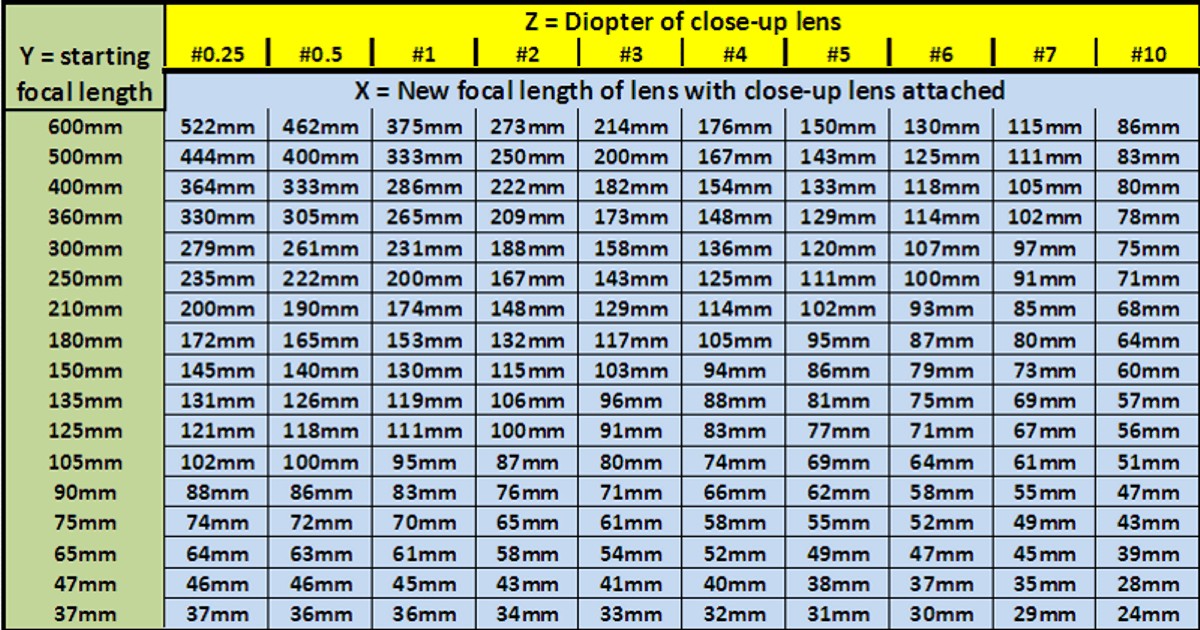

It's not pointless at all because it depends on the image circle of the lens, and the strength of the close-up lens being attached.
The image circle created by the lens will decrease when a close-up lens is added, of course, and the stronger the diopter, the smaller the image circle will become. And if the image circle shrinks enough, you are likely to lose the corners of the image. This is especially true if the lens -- without the close-up lens attached -- has a small image circle to begin with.
But if the lens has a large enough image circle, and/or a relatively weak close-up lens is being used, there will be very little loss in the diameter of the image circle.
Formulas for computing this can be found at:
http://www.subclub.org/fujinon/close-up.htm

I have no idea how you came up with those numbers. A 180mm lens with a #0.5 diopter CU lens creates a 165mm lens. A #1 diopter CU lens gives you a nice 150mm -- and stopped down to f16 will give you great results with little loss in image circle..

Anyway, as the table shows, a low diopter CU lens can make a significant change in the FL of a lens -- with very little loss in IC. And there will be little loss in quality if the lens is stopped down. The IQ loss can be reduced even more by employing an achromatic CU lens -- these are more expensive, of course. Here's the best list I've seen:

Hold on a second. I've got that Opteka too -- great CU lens, but that is a #10 CU lens. That would turn your 180mm into a 65mm lens -- look at the table. I use the word "would" because that combination won't work. Try it and see for yourself -- assuming your bellows can collapse that much. You'll end up with a 65mm lens with an image circle of 110mm (assuming no additional physical vignetting). That might be OK with you if you don't mind cropping, but the quality????? That's "pushing the envelope" for sure.
