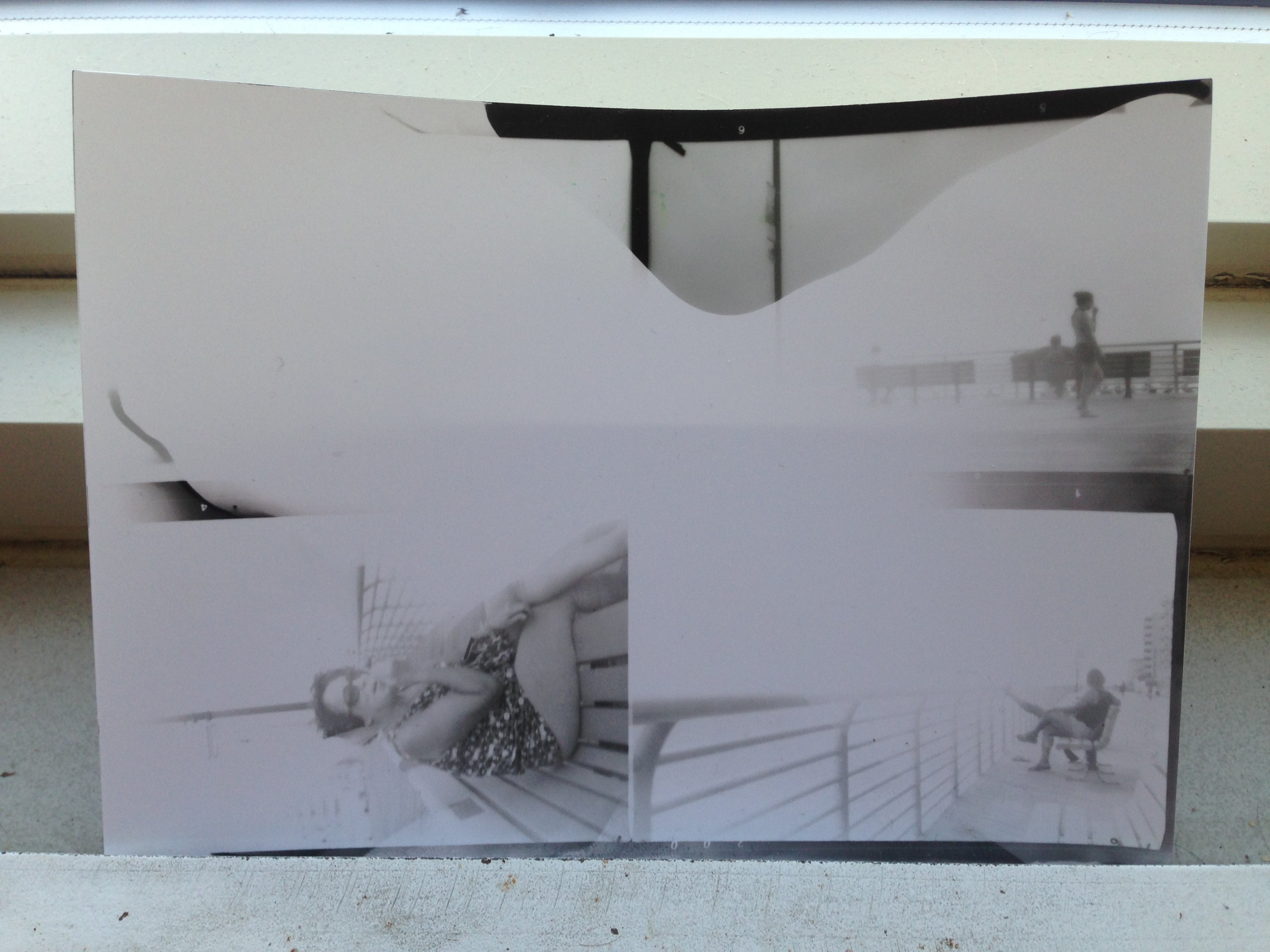

I tried last night to make contact prints for the first time, holding a lamp with a 40 watt bulb over the negative and Fomalux 312 paper in a contact print frame. Every print I made (I tried about 5 times) only had one small, bell shaped part of the image exposed. I tried different lamps and bulbs and every time this happened. For the last one, which I included as an attachment, the bell shape part developed under the developer, and then when I put it in the water bath (I use TF4 fixer) the rest of the image appeared hazily. I can't for the life of me figure out why this is.

My first thought is that looks as though the print wasn't wet quickly in the developer. Was the developer deep enough to easily submerge the print? The other question would be how far above the paper was the bulb? I usually use my enlarger as a light source and crank it up to the top of the column which puts the lens/light aperture about 25 inches above the paper. That is also a known, even, collimated beam. In bygone times to contact print on film I have been known to use a small automotive bulb hooked to a toy train transformer (!) and suspended four or five feet above the counter. That creates a relatively even illumination from a point source of light.

I think either your elbow got in the way or the paper didn't get into the developer evenly.

What developer do you use and how long do you develop? Perhaps you "snatch" the print too early.

Your sample looks to me like not getting developer to all parts of the surface, possibly combined with a short developing time.
You need to standardize on a developing time. Usually at least 1 minute for RC paper and double that for FB. A 40 watt bulb may actually be too bright to get a reasonable exposure time with those dev times.
Watch to be sure you're not casting any shadows on the paper while exposing.

I think I did use too little developer, about 400ml of Dektol diluted 1:1 for 1 minute. This was for 5x7 prints in 5x7 trays. Looking at the print it curls a lot, so that makes sense to me.
Fomalux is a silver chloride emulsion, a true contact paper. I routinely get 60-75 seconds exposure times using a 60W bulb hanging from the ceiling about 3m above the paper. My dev time is 3 minutes, using Moersch ECO 4812.
To the OP: what do you mean with "the bell shape part developed under the developer"? Did you develop the prints face up or face down? If you developed them face up, it may be that the prints floated on the developer and left the emulsion deprived of enough developer to complete development. I usually gently stab them when developing face up, with a rubber print tong.

How did you handle and agitate the print during each stage?
I start by placing the print face down into the solution. I then ensure that the print is fully covered by the solution. I then flip the print over and agitate regularly, making sure throughout that the print remains submerged. When 10 seconds remain in the necessary time, I pick up one corner, and then let the print drain for the remaining time, before transferring the print to the next tray.

What he said plus more developer.

Looks like what happens when the paper gets partially submerged in fixer, prior to development.

Thanks for the help everyone! I followed those instructions and make 6 prints. They came out evenly but they're not nearly as sharp as the negatives. I read that that means there wasn't enough pressure between the glass and paper and negatives, so I'll have to take another look at my frame.

I'm assuming the shapes on the paper were different for each print? This could further substantiate the developer submersion idea.
