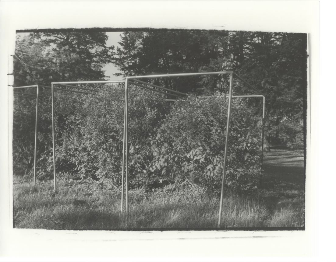

For my latest adventure I had in mind that I wanted to print on some Grade 2 matt finish paper that I had just bought.
I used step wedge and densitometer on this film so I know my film was underdeveloped about 25%.
But despite it being wrong, I printed several shots the best I could on Grade 2 paper anyway because I really wanted to try the new paper.
It’s obvious it’s too flat.
I have notes and think the reason for unexpected results is old developer. So I can “fix” this by using fresh developer next time. But I would never have noticed this if I didn’t “have to” print on Grade 2.
