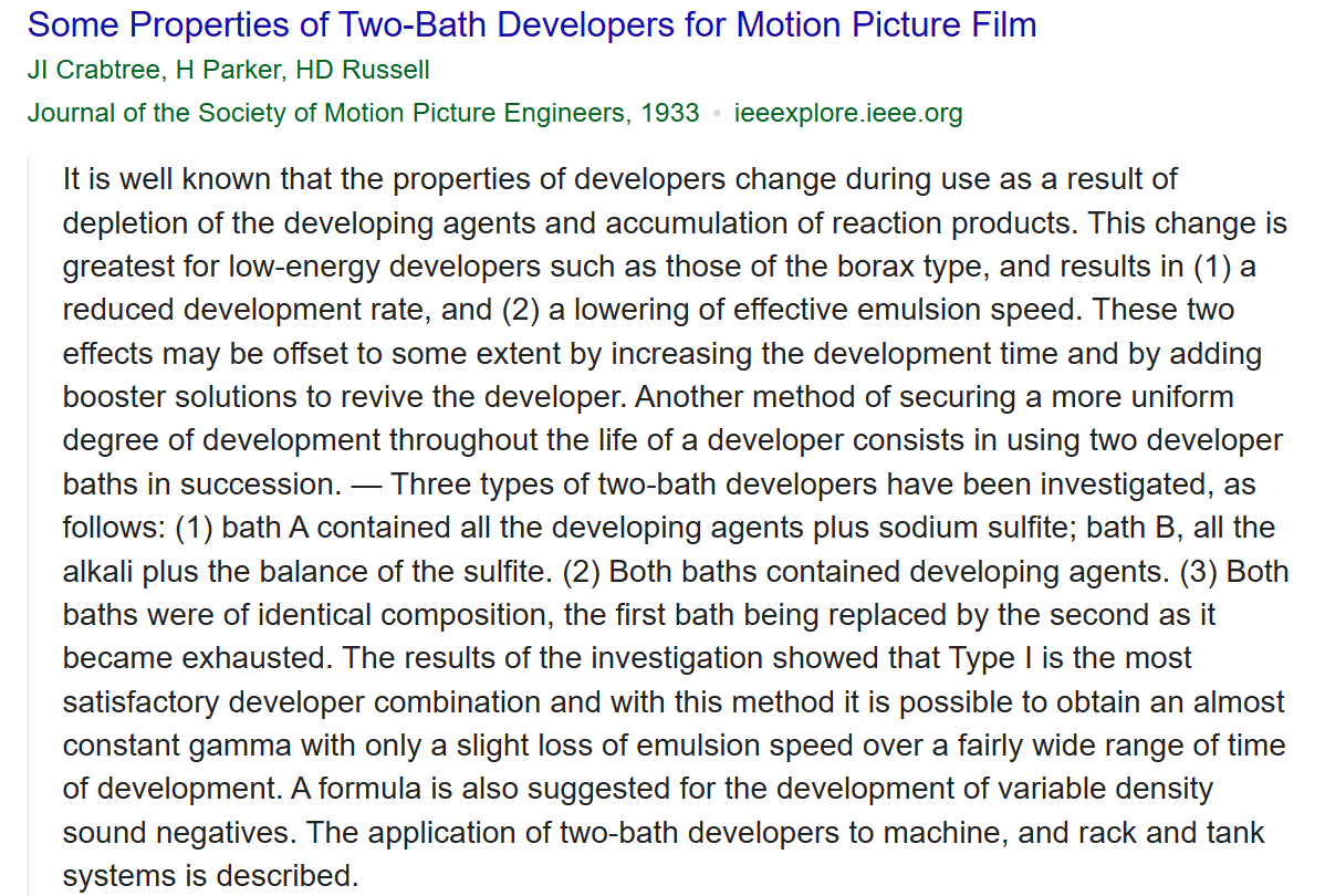

Interestingly, two-bath developers were found to have certain advantages over conventional developers when it is necessary to get "a more uniform degree of development throughout the life of a developer" as would be the case in motion film processing.
I could certainly see how two bath developer modifications could be applied for motion picture film development - those long reels of film run in high volumes through the machines.
But commercial labs that develop many short rolls of film - that would be more of a challenge.
Unless the labs were able to approach them the same way as Kodachrome - many customer rolls, all spliced together into a long single roll, run through the machines, and then separated at the end back into single rolls.
