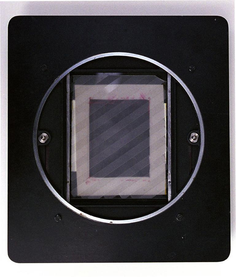

I would like to see Dave over at Satin Snow make one of these.:D
There are some new items on their web site, I'm still looking, it's not often that I find something new that is interesting. Whether it is of any practical use is not clear.

The Anstendig Institute
Well, from the website, he seems like kind of a crank, but I'd still be interested in trying a new kind of focusing screen, whatever his justifications may be. I suspect Dave could make such a thing. It would just involve masking the screen to grind it in that pattern and it would have to be done on two surfaces, and it would have to be positioned so that the plane of focus falls between the two ground surfaces.
I still have my doubts that it's better than just a plain groundglass. It seems that the principle of the Messraster is that you look at the whole glass to see when it all looks uniform, and I'm not convinced that that would be better than magnifying the surface of a plain glass with a loupe.
Helen B
Jul 1, 2004
1,590
Hell's Kitch
He doesn't understand how to use a clear screen with a graticule for accurate focussing on an aerial image either. The way he thinks it would work just doesn't work, which suggests that not only does he not understand it, but that he's never tried it. He doesn't even mention emulsion depth and the tiny variations it causes in the optimum image plane. He's obviously not a Class I Nitpicker. Must try harder.

It would be far easier to paint the 'messraster' onto a glass than grind it, I think they are looking at a .0001" seperation between the 2 views on the same side of the glass. The only problem is there would be no way to keep this precision with film holders or film.
He may be nuts BUT he's actually correct with most of what he has posted. There is NO depth of field, just check the aerial image with a 20X eyepiece. DOF is an optical illusion provided by the GG, be happy the emulsion provides it also. :D
