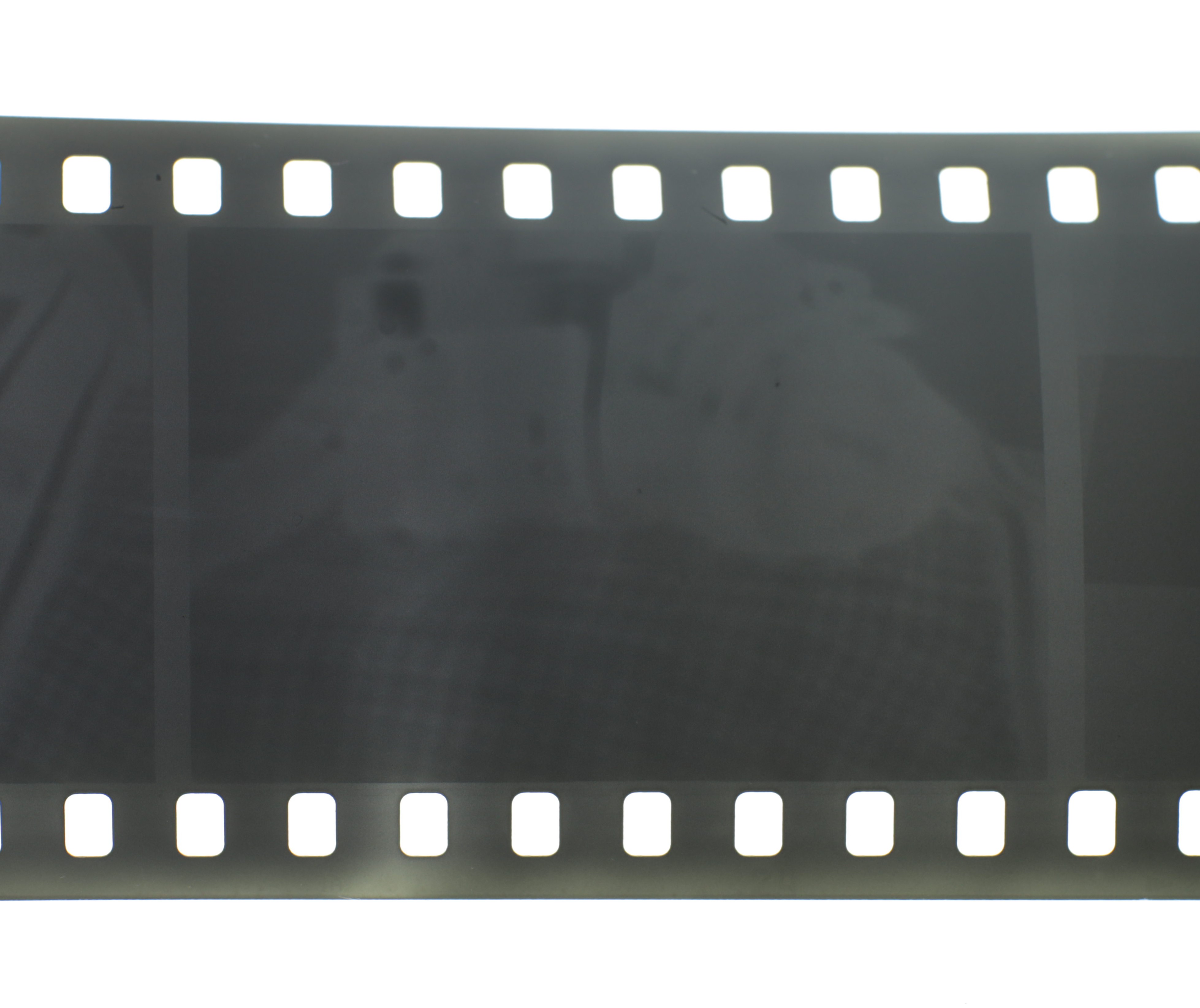

I am using this TriX bulk loaded film for over two years. During last last three weeks I have used four rolls, all of them came out such dark as below after development. The example below is the worst, but in other rolls, although the images could be scanned the negatives look such dark.
Please tell me why this happened?

That film is fogged; meaning its been exposed to light. The edges, the part outside the image area, should be clear. Overexposure or overdeveloping, which can make the image too dark on the film, will not affect the blank edges, but the film being exposed to light will darken the edges. You darkroom or your developing tank or your camera is not light-tight.

What makes me doubt is that the density gradient appears to be going in the 'wrong' direction:
I'd expect the edge to be darker, not lighter.
You might argue that the light may have struck from the other side - but that edge also looks lighter, not darker.
Another thing that makes me doubtful about light fogging is the fact that there's still a clear image. Usually way room/day light fogging the entire image is obliterated. The kind of fog shown here is however a good possibility of the film was fogged to red safelight; this sometimes happens if people get confused/have a momentary lapse of reason and load their red-sensitive film under red 'safe' light conditions into a development tank.
Other sources of fog are possible - but I'd vote for light struck as well.
Try developing a short snip - just a few frames - that hasn't gone through a camera, and see what you get.

Along with loading the tank with the safelights on, this could also be the result of chemical fogging. If you have some different film - HP4, TMX .... - try developing a snippet of unexposed film and see if it comes out clear or fogged.

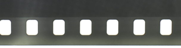

Actually, I have shot all 4 rolls in different cameras, which are known to me as working fine. I can show you other snippets where I have found workable images. Thirdly, other rolls are evenly stained dark brown. I have tried to test my fixer on a snippet from the same bulk roll, it cleared perfectly except two thin edges above the sprocket holes.

How old? If it's (more or less) uniform through the entire bulk roll it could be a number of things.
Something is happening that is allowing the developer to produce black metallic silver. Unless, (it's not clear from the photo), it's some type of an uniform stain.

Did you ever get good images at all from this bulk roll of film? Maybe the entire bulk roll is x-ray fogged. This can happen if it was subjected to very intense x-rays for inspection purposes.

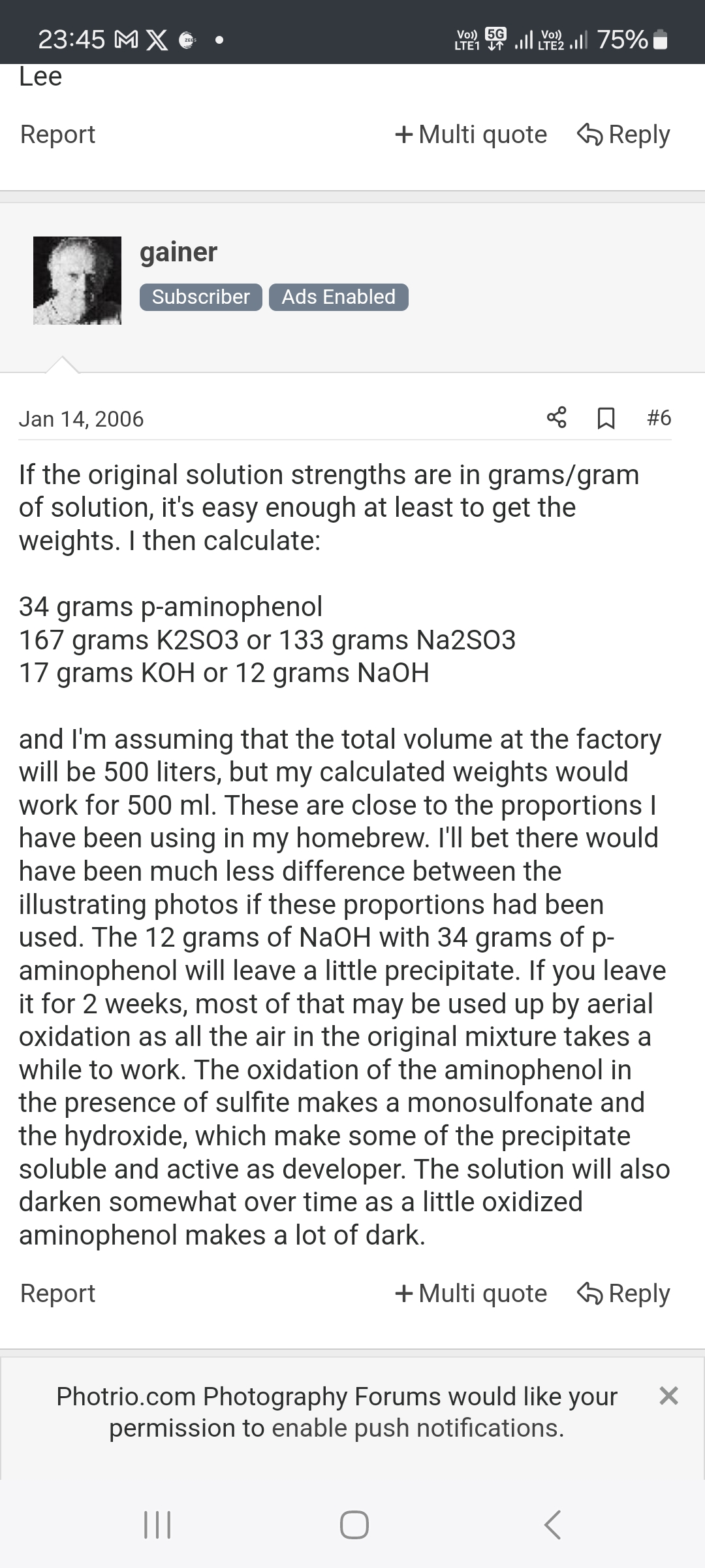

Wait define " home made Rodinal"
I have made Rodinal following the simplified Wolfen formula posted here (apug) by Patrick Gainer in 2006. Screenshot shared below. I have developed before using the same preparation, which produced very good results. But, that was a different film.

That there is image as well as severe overall fog suggests to me that heat might be the cause. I bought a roll of Neopan400 in southern Mexico from a kiosk at an archeological site that was well with its use by date and I was shocked by the amount of general fog. The OP has described very hot conditions, and the film might be fairly old.
