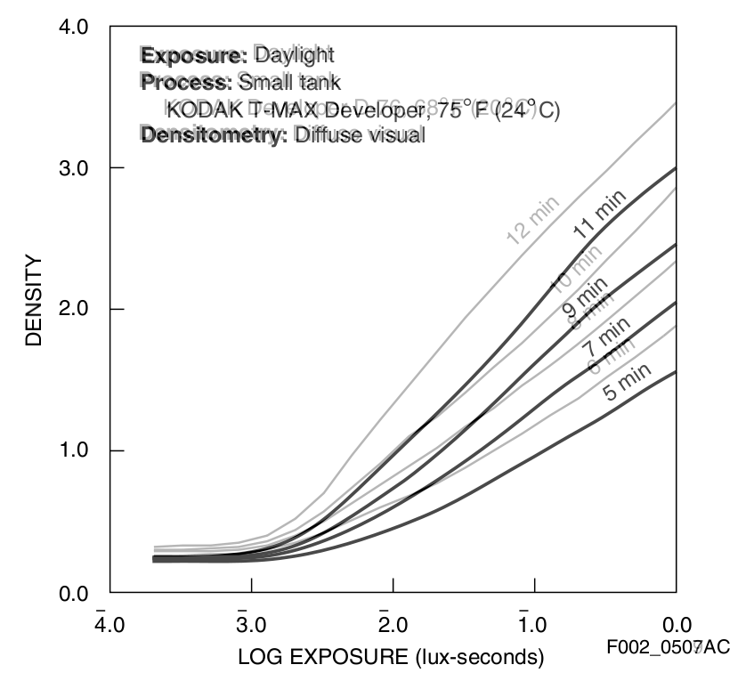

What the chart I linked to doesn't show is the changes in characteristic film curves with changes in developers. So, for instance, when Andrew Moxon likes the tonality of TMax developer better, and there is no practical difference in other characteristics (grain, acutance, film speed) at the print size he prefers, then he choses TMax over Xtol for his preferred tonal curve.
The curves from Kodak for TMY2 in D-76 straight at 68F and TMY2 in TMax developer at 75F are overlaid in the attached image. The darker lines are TMax developer.

Well, Xtol is a damned good compromise. It does most things really well, and very little wrong.
But as Andrew says, pick one that suits your purposes and use it.
There are differences, and they may become more pronounced depending on how you vary your film developing technique. Some developers respond better to reduced or increased agitation than others, and this helps you shape the film curve, which in turn has an impact on your final results.
And, when you print big, the differences become more pronounced.
