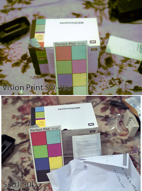

Pinch of sulphite - just a very tiny amount, take it from the 9.6g/L amount that's been measured out. I just formed this habbit when mixing developers, probably from doing it with Metol.
the CD-2 is mixed first, then the rest of the Sulphite. The Sulphite removes the HCl molecule off CD-2 iirc, and the H2SO4 off CD-4 and CD-3 (if you don't include a base initially it wont develop).
The bisulphite drops the pH down a bit, you can go lower than I did, but 7.1 is low enough for most purposes.
Some development has to occur in Bath A, or it is useless.
I've tried it with CD-3 before using ECN-2 film, I omitted the Sulphite as I wanted maximum saturation/dye formation etc in Bath A. Not even 4x the equivalent amount here of colour developer agent worked. I got very thin images from +5 stops overexposed, and that was it, and they were terrible colour iirc.
Development occurs in Bath A. Not much, but a reasonable amount. You can therefore alter affects and density with variations in time in Bath A.
Bath B continues development, but halts to a stop when it runs out of developer.
The last one I tried with CD-2 as at 7g/L which worked very well a well with limited testing on obscure films.
Print Film Test #3 by athiril, on Flickr
I was interested in it at the time to try and get good in camera pictorial results out of Vision Print Film (I've since had some luck with it using diluted E-6 first dev at 30c iirc and processing the rest as E-6), and put some 50D in as a control.
The recipe differs to the one I used here for the Agfa film in amounts and ingredients.
