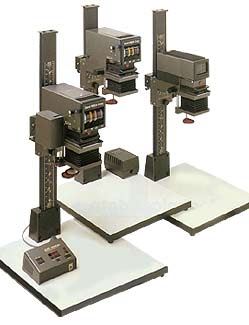

Check out the enlarger on the left, it has the the two swing in filters ... is this the Pictograph version ?

Confirmed by a semi-retired Durst Serviceman. The clear lens should be diffused and used with the colour/B&W analyzer. The clear lens is a place holder.
Not sure which version that was but I don't think it's the M805 Multigraph
