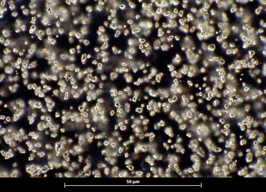

This is a microscope photo I made of developed TMY-2 film:
If we have a bright background the silver looks black because it is not translucent.
