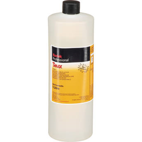

There is discussion about HC-110, D-76, Rodinal and many others but I seldom see any mention of T-Max Developer.
My experience is that T-Max Developer is far better than HC-110 Developer especially for grain''
Rodinol produces fine grain but with a severe speed penalty.
T-Max imaging characteristics are the same as D-76 but T-Max is chemically more stable.
For pushing T-Max is better than any other developer. It yields mid- and upper scale density without fog or grain increase
Is price or availability an issue?

When Kodak first started to produce Tmax 400, 100 and 3200 it seemed that Kodak would want to market a developer matched to T gains strengths.
Which version of Tmax is being discussed here, original or the new "New formula" release?
