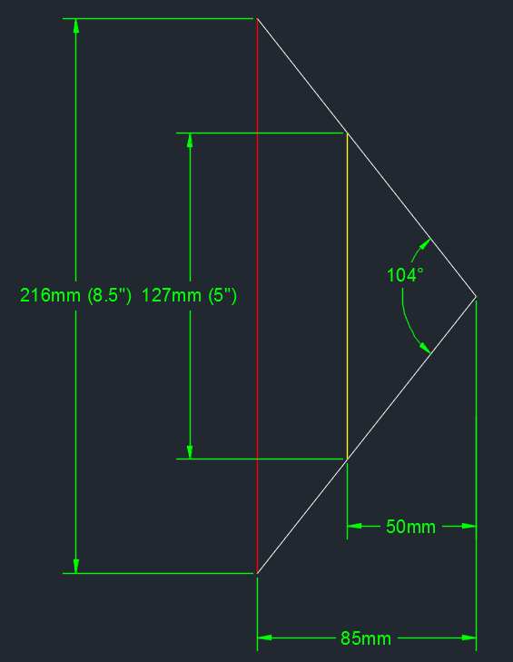

The point has been driven home to me recently as I am looking to re-create Bill Brandt's signature wide-angle look. I've found that he used the Zeiss Protar f.18 8.5 cm. lens Serial No. 1355381
I've tried to find the equivalent angle of view for different formats and the corresponding lenses. But so far, I don't have a shopping list because the equivalents aren't up on a website somewhere for me to compare.
I recently saw an Angulon 90mm sell for a reasonable price here on APUG.
But I asked myself... Is 90mm wide enough? It's only 5mm "longer" so it might be. Except the Angulon is not the "Super" Angulon, so it would barely cover 4x5. And Bill Brandt was shooting "full plate" 6 1/2 x 8 1/2 inches... I shoot 4x5 inches.
Using the long dimension of the film, 8.5" and an 85mm lens gives an angle of view of 104 degrees. On 5x4 the same angle requires a 50mm lens. That 90mm lens on 5x4 will give you 70 degrees.
EDIT: I appreciate that you probably know this and I don't want to appear patronising but I posted it for the benefit of those who don't know. If you have use of a CAD program, it's easy to draw up a triangle like this using the film size and focal length and then measure the angle.
