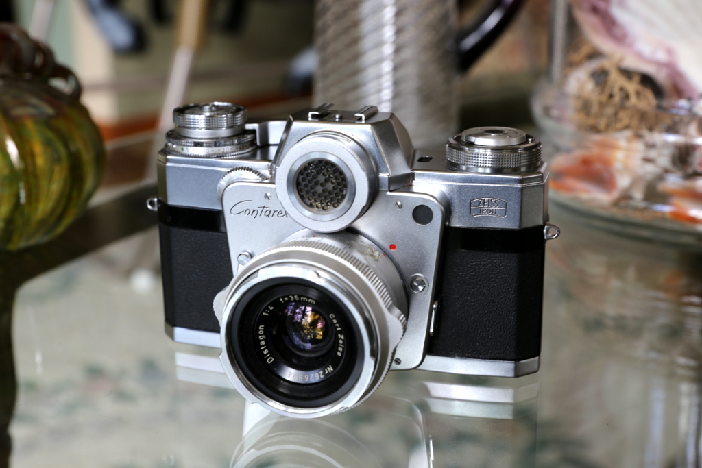

I bought a Bullseye body at an online auction but not knowing if it worked or not. I love the look and I would add it to a small collection of cameras I have on display. Everything appeared to work when I got it but without a lens I didn't know for sure. Some weeks passed and at a camera show someone was selling the 50mm so I decided to buy it, but when I mounted it and fired the camera the aperture blades wouldn't close even though they moved freely with the lens off the body. I decided to pull of the lens mount to see if it was something simple but now when I fire the shutter the mirror doesn't flip up unless you manually flip it up and down first then it works. I wasn't going to spend the money to have it fixed so now it sits in a glass cabinet looking pretty. It's in great cosmetic condition and I figure when I buy a mirror less camera I would use the lens with an adapter.
The picture is showing a 35mm lens that came with the 50mm but unfortunately the focus is frozen which I understand is not that uncommon.
