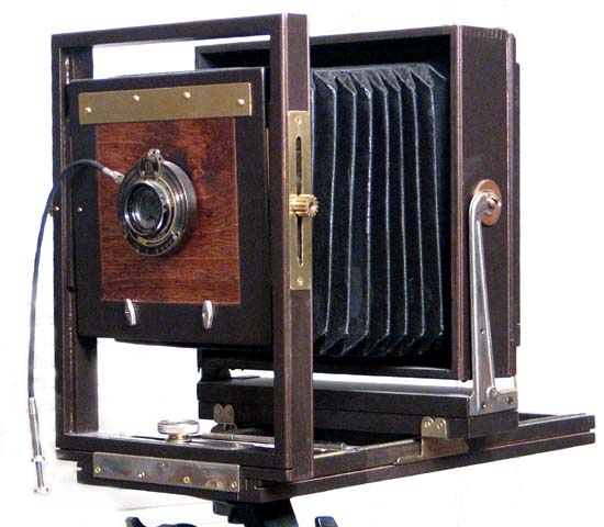

After reading what I posted it looked like I was spending too much time on eBay. It's not for sale because I made it and there is personal value there. Of course I could make them better today with more experience and a great shop to do it. I am going to make a couple of 5x7's like the Hardin cameras. I have the hardware already and a new 5x7 Canham bellows:D .

Anyone notice the design of the front standard? Some have the support in front like I did and some have the support in back like the Tachi. I noticed the Titan has the support in front and the AO of David's is in back as are the Deardorf cameras. The drawback of the front support is it puts the lens plane back further but it folds without turning the lens holder of the standard. Mine doesn't have lens tilt, only front base tilt. I could have designed lens tilt though. The Tachi. and the Shen have these two different designs. It probably doesn't make much difference but it's there for some reason, I could never find anyone who could clearly define it. With a larger camera the "support" of the front support make a lot of sense, that is, having it in back. The front support can pull up on the front plate if the front plate is made thin but with a lens it is balanced out with the weight on the support. Any ideas on the design of the front of these cameras?
